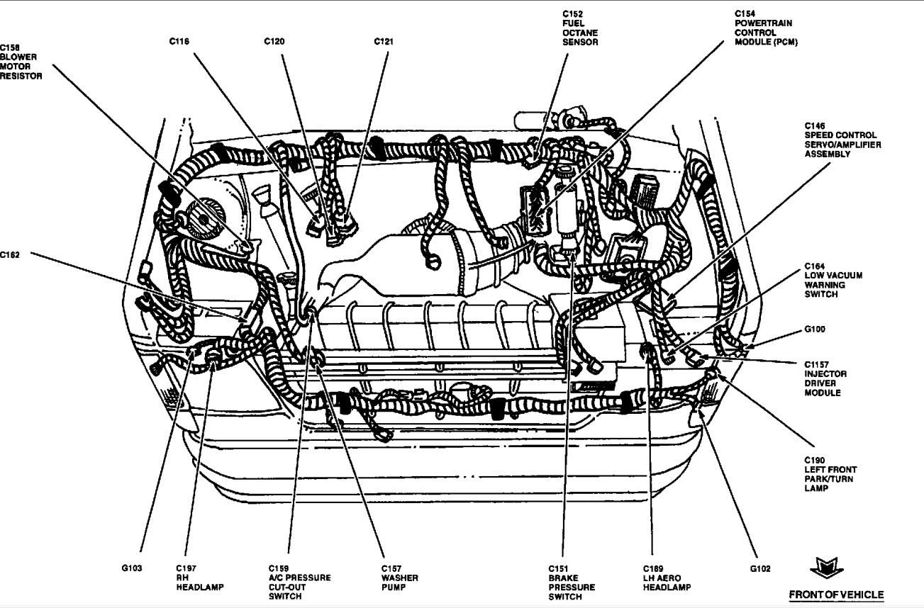

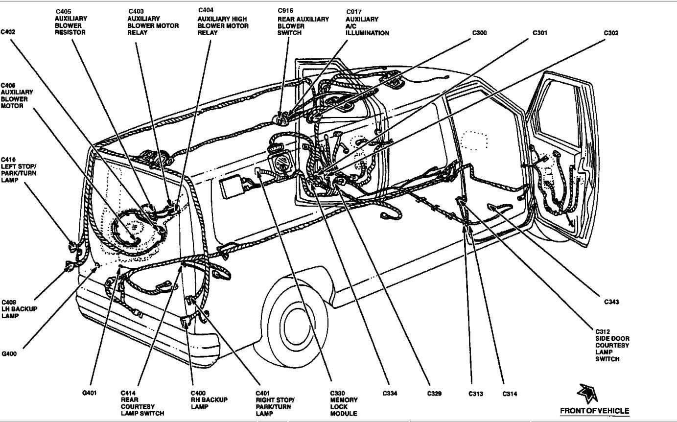

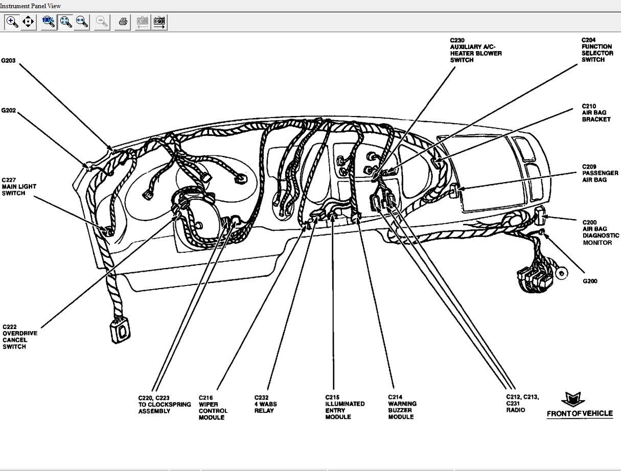

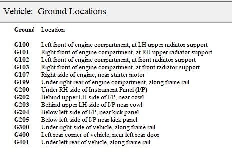

You said whole van no power, so don't worry about the starter yet, you need to restore power first.
I'd test your grounds first, especially where your battery ground cable is terminated.
You test the resistance against your battery ground terminal: Ohmmeter set to 200Ω, red to battery ground post, black to the Gxxx shown below, randomly pick a few, additionally pick another point on the engine block, if you get 5ohm or less, then your ground is fine. If not, red to one of the Gxxx, and black to another Gxxx, check and see what you get.
Thank you Heiko for these diagrams and information. It will be very helpful with some of the electrical problems I've been chasing for years.
As far as my current (pun intended) problem, Hanky hit the nail on the head with his first suggestion of the battery connections. I removed and cleaned the battery terminals and it seemed to make no difference. As I checked all the other things, they were fine, which kept leading me back to the battery. It turns out that even though the battery was good and the connections were clean, I kept testing for battery power on the + and - lugs and not on the actual battery ends clamped around the lugs. They were replacements that had the cable end held under a clamp (pic attached). Over the years a screw came loose, still making enough contact to hold the cable in place and register on the multimeter but not enough contact to allow the full voltage to pass through to the solenoid and starter. It was only by chance when I took the cables off once again that I noticed the one loose screw. I replaced both with new terminals, for now, and the problem is solved. I'll replace both with new battery cables when I get the time to measure length and wire gauge.
