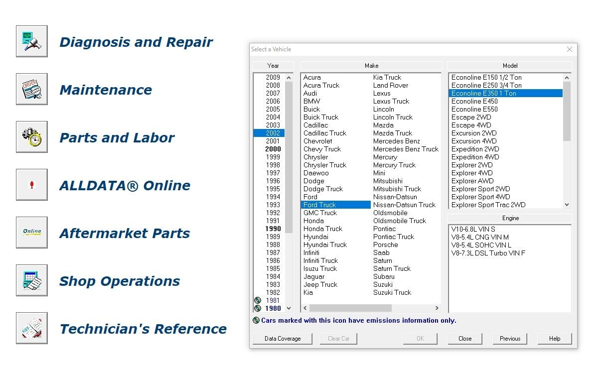

OK button not clickable because engine size is not selected. Check my signature below to see why. If you have a 5.4L what's the 8th character of your VIN, M or L?
