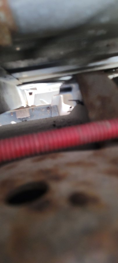

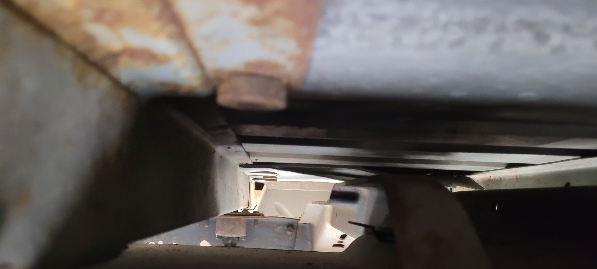

I can't find the fpdm, I looked in the usual locations like by the fuel filter and back by the spare tire, cross members.
So I took some pictures on top of the fuel tank. I see something about a foot in back of the fuel pump which may be the fpdm? See attached pictures of left and right side.
If it's not the fpdm, what is it?

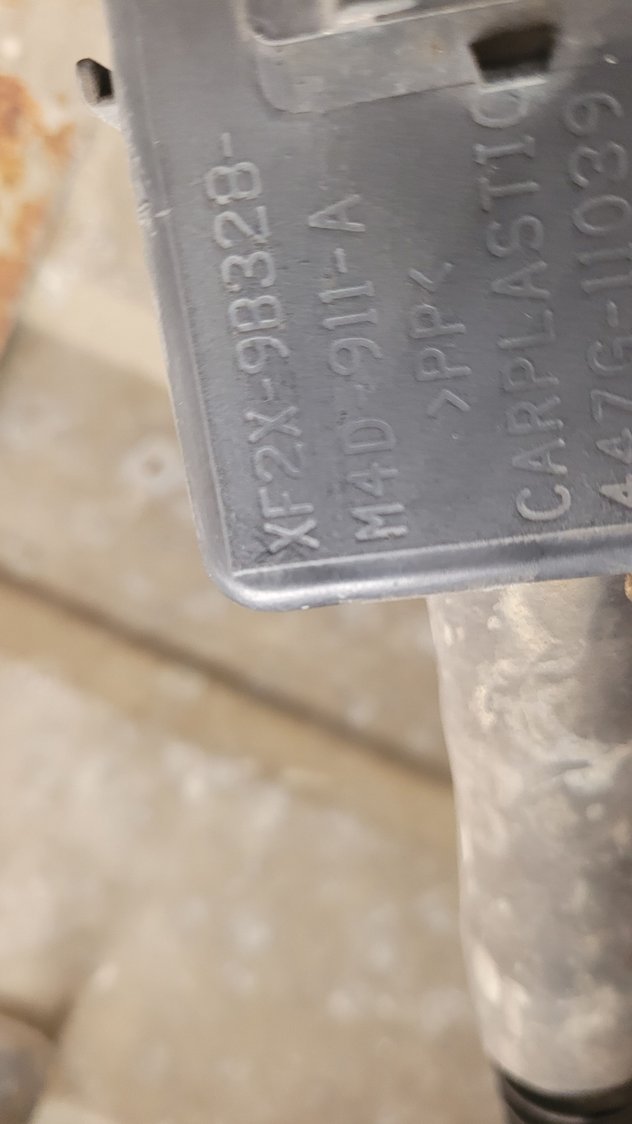

I did lower the spare tire and looked all around and didn't find the fpdm. The only wires I found by the spare tire was to a small black box marked xf2x-9b328 m4d-911-a, see attached pic
