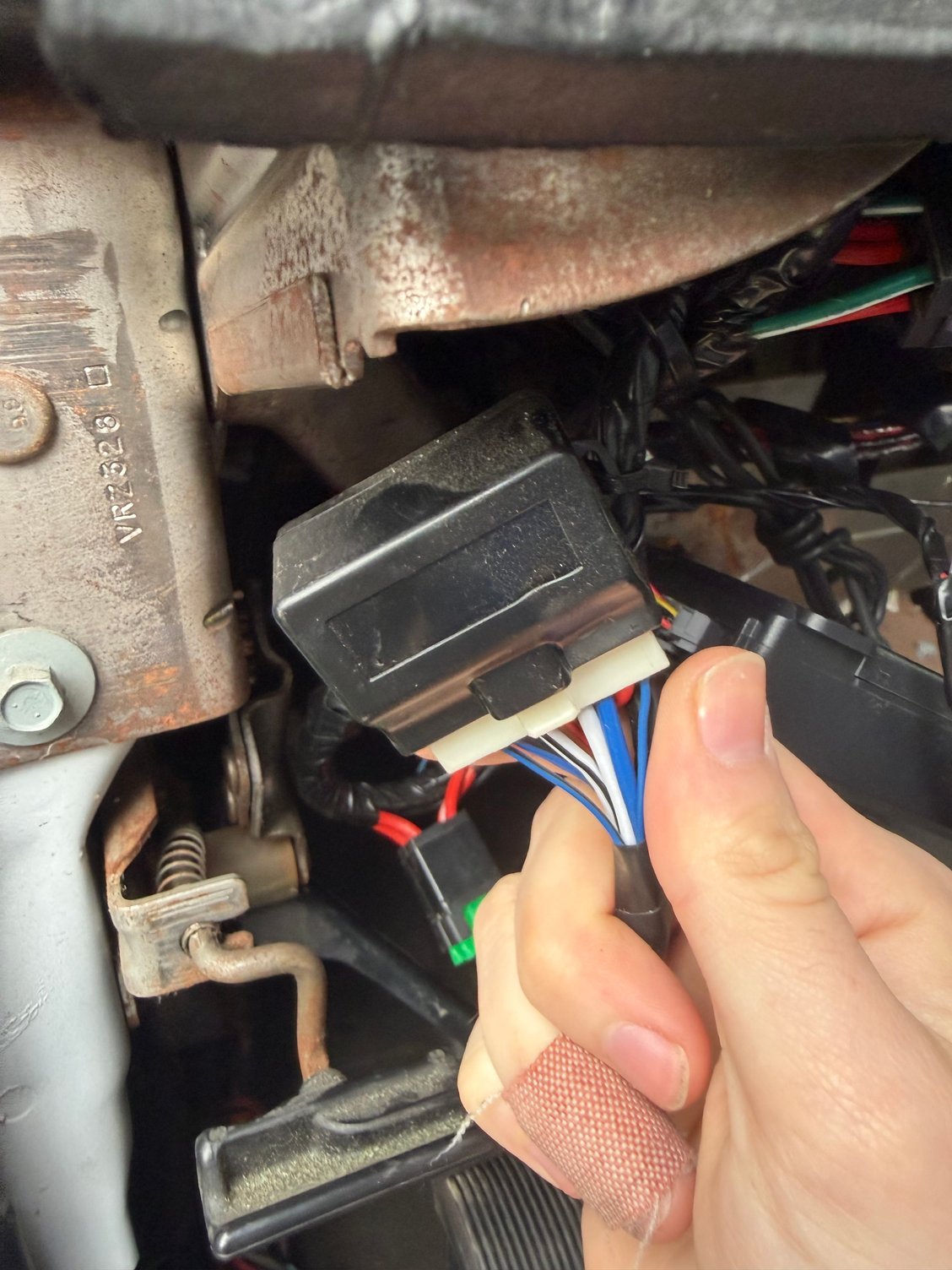

Think about whatever these may be before the following info: there is a CM-900 aftermarket system installed. I received two non oem fobs that correspond to the system that do not function and did not function for a while before I bought it. Fuses for OEM lock system were missing so replaced those before I knew this computer was there. Post fob battery replacement one seems to have a fried board (liquid damage?) and the other one the light flashes to one or two button presses but also doesn't seem to work/dies immediately. I had no idea this was installed at the time I bought it but whatever. I go outside one day after having driven it <1 hr before and it is running... doors locked, ignition in off position. Text the old owner and he says yes I did have autostart installed, prompted by the key. My girlfriend had a key/fob in her pocket so maybe it gave its dying breath to autostart it? Condition hasn't occurred since as far as I can tell.

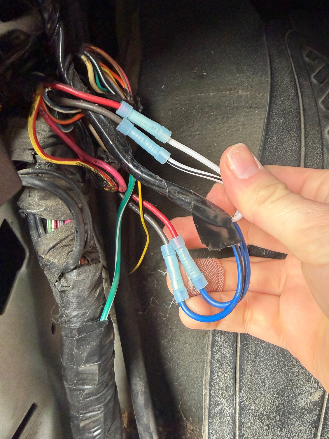

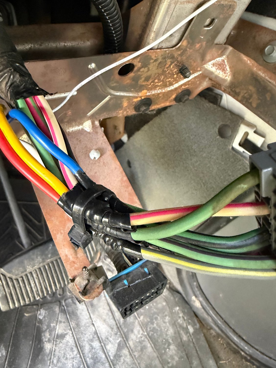

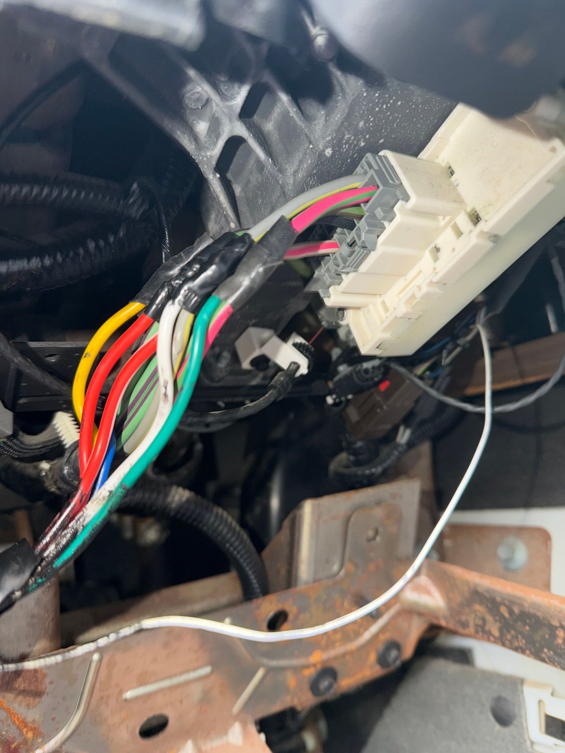

Began poking around with the wiring to try to get at least lock functionality back, moved white/pink and green/pink (supposedly the lock/unlock wiring) in the main loom going into the ignition back to OEM wiring and it did not make driver or passenger side work. There is also a little module spliced into some brown/red wires near the door jamb (lock wiring from door loom?) with no info on it. There are two sets of fuses coming off of the computer two large green 30 two blade fuses and one large red and one large blue installed in the little offshoot module. When I fully unplug the computer but leave the plug in the ignition (wires from CM-900 still installed) the car won't start. I put everything back the way I found it and cars starts and runs great. Can't tell if the car is in valet mode or not but have tried everything in manual to get it out of valet if that is the case but that does not seem to make a difference. Fobs still dead.

unmarked "extra" module still tied in to CM900
CM900 seems to be an older model
red/brown wires spliced and going to unmarked module
straight into the loom nice
cruise for reference

loom alternate angle

Not familiar with the system you mention, but I have found when someone installed a system or had it installed and now we have problems with it , either have the installer check it out which will cost $$$ or remove it and go back to original, if possible. There is no easy way out on this..
Now we know why they sold it. .
I suspect there may be a broken wire in the area where the driver's side door opens and closes in that hinge area.
