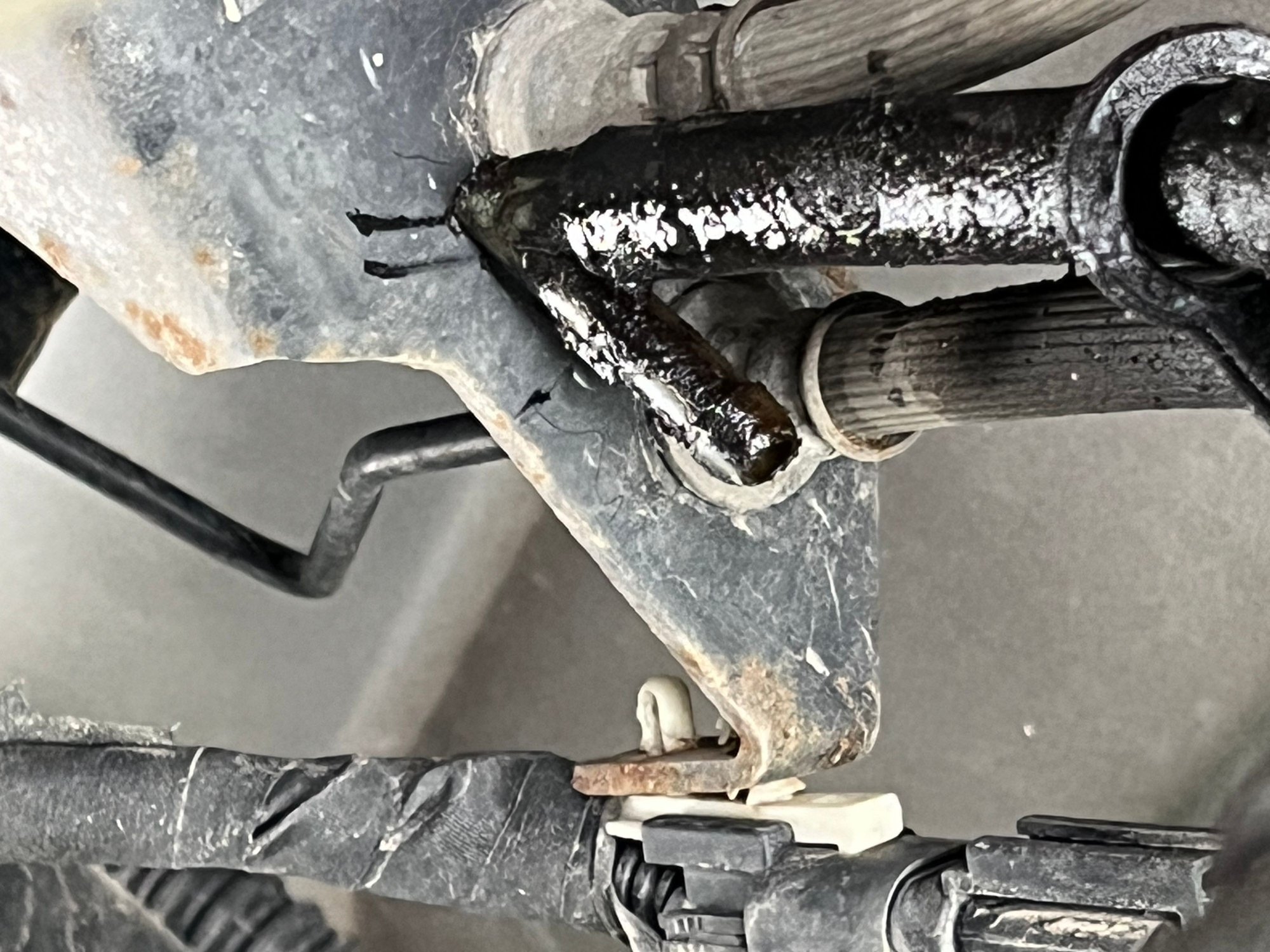

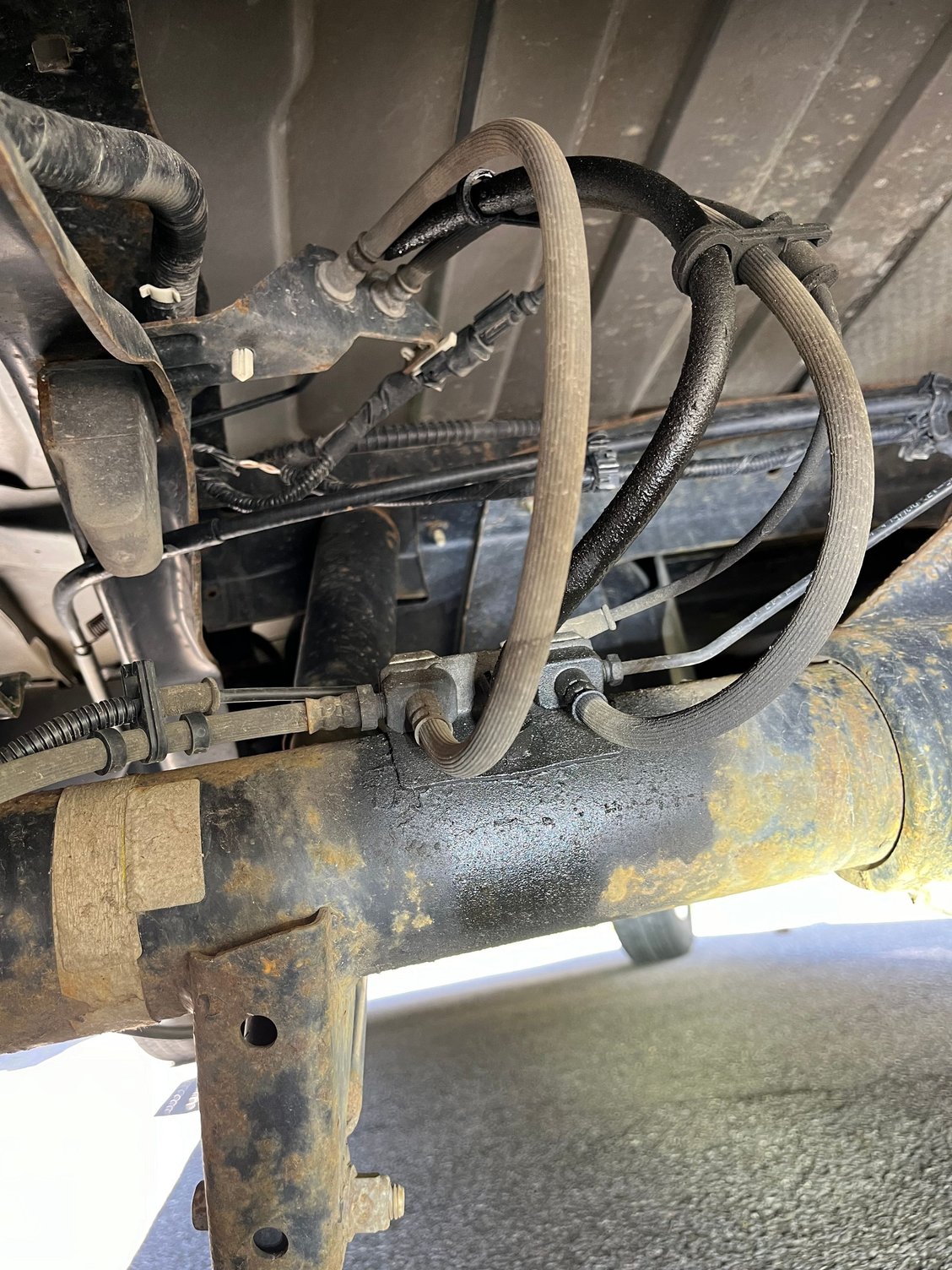

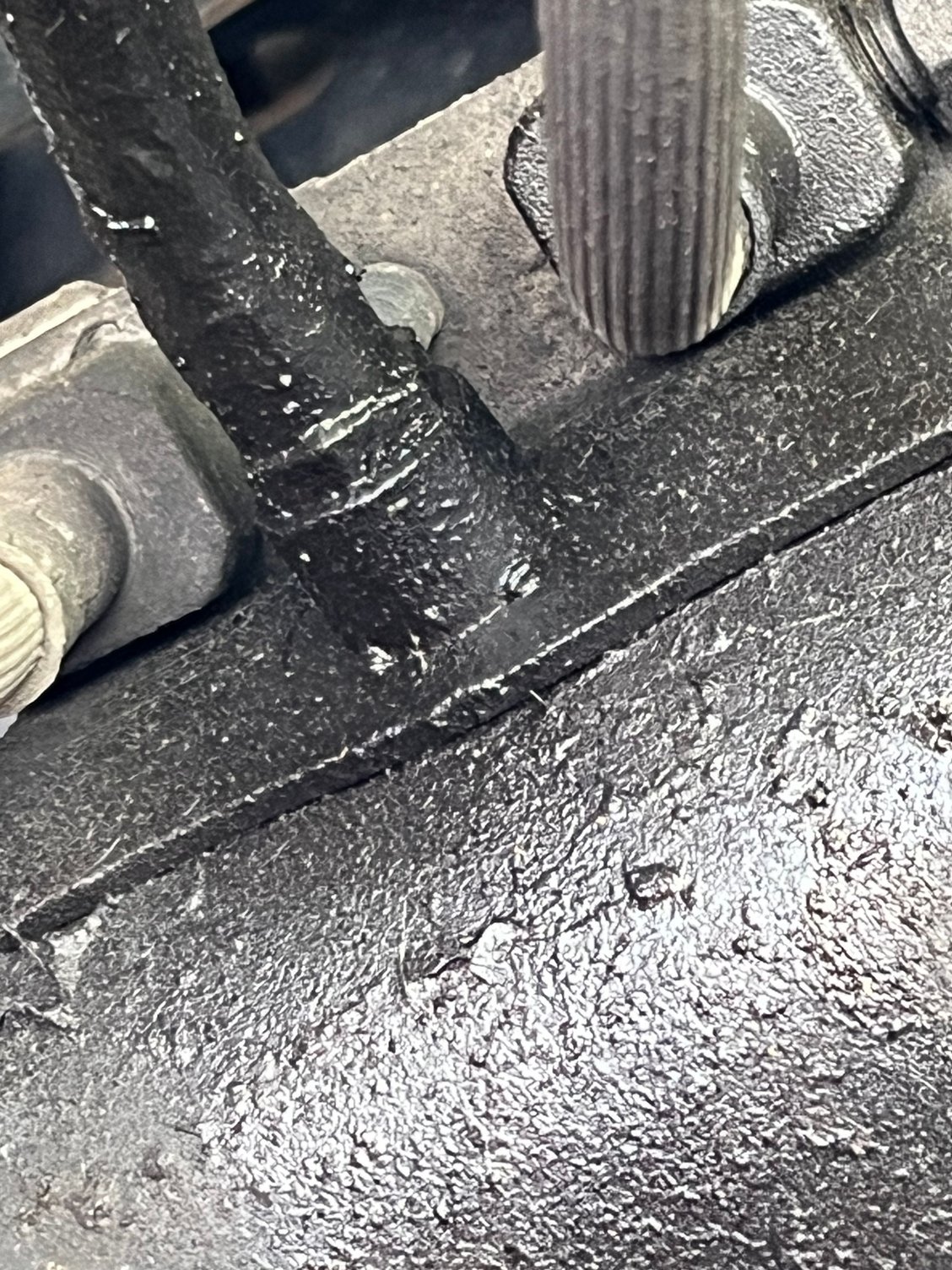

this hose is connected to axle and has V connector on other end with nothing else attached to second side of V connector. I think differential fluid is leaking from V connector. What is this hose and what other hose is missing?
Black(wet) hose in question
V connector
V connector
Axle connection
Old Apr 23, 2024 | 12:08 PM
It's the axles vent tube.
It should be open on the fitting end, and remain in its position well above the axle. The angled fitting in a downward position and aimed towards the rear of the van. Generally you don't see any lube residue. Might check the lube level. Has anyone service the axle?
