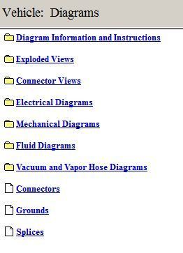

Old Feb 8, 2025 | 03:23 PM

Okay, a couple more pdfs below.
I have alldata any cars up to 2009. Let me know if you need anything in particular.
