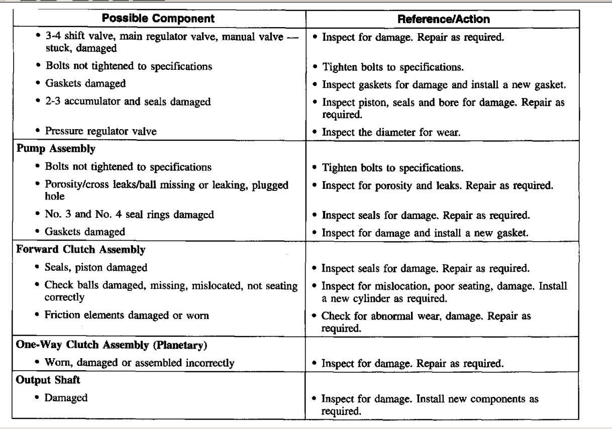

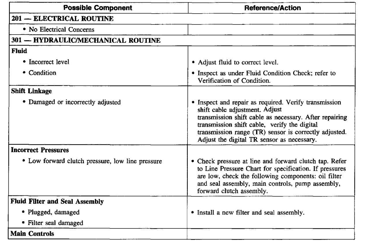

Diagnosis-by-Symptom index pages shown above.
Pinpoint Test index page shown below:
Routines 201 + 301 shown below, download the pdf below to see all routines.

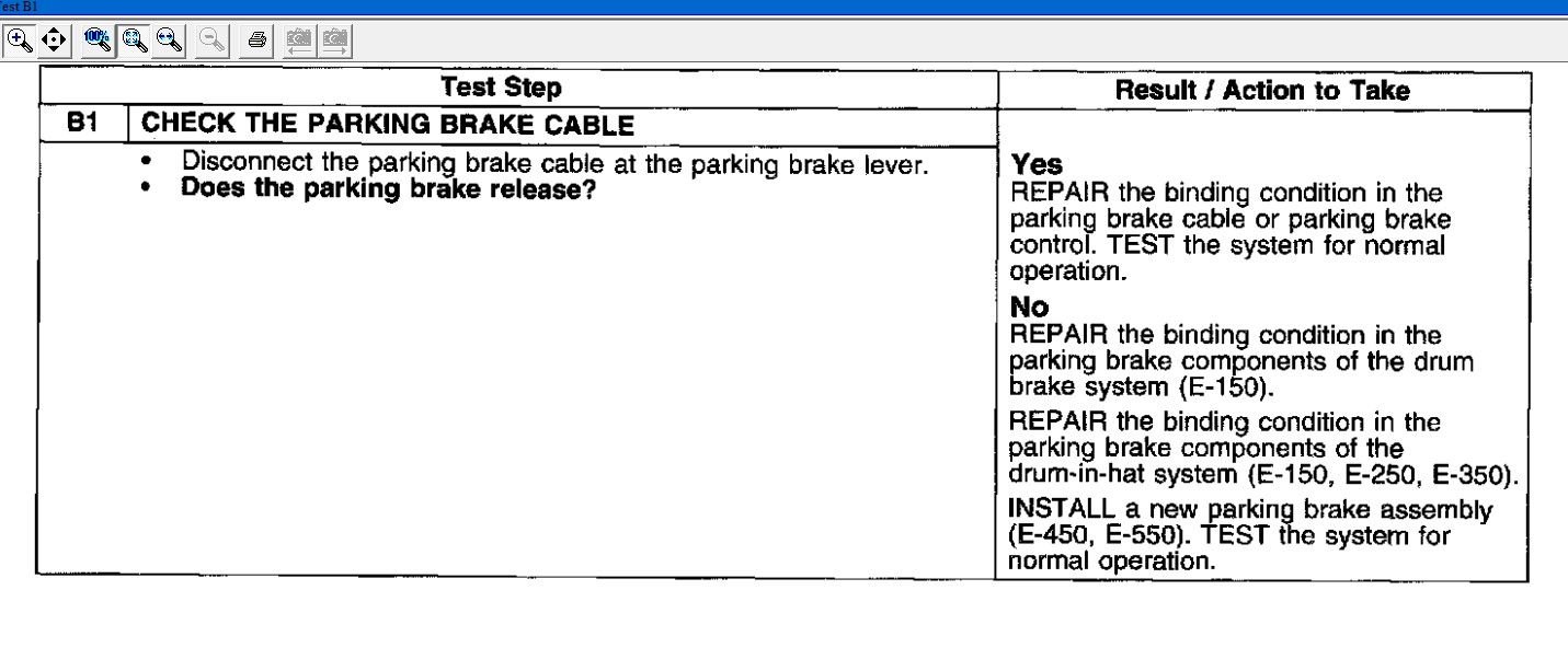

Just a thought... Does the van roll in neutral? I had something like this happen a few years ago where I parked my E150 for a few (rainy) days and when I tried to use it one morning it wouldn't move. Same exact symptoms you describe. I had it flat-bedded to my mechanic who told me my parking brake was stuck, rusted in just a few days of rain without use. The parking brake pedal would release like normal but somewhere along the cable it was stuck, keeping me from moving. It was an easy fix for my mechanic but an expensive one for me with the cost of the flatbed.

But he said only no forward, reverse works fine though. If parking brake was stuck he can't move at all.
Old Aug 29, 2025 | 04:17 PM
etinpa's Avatar
Joined: Oct 2023
Posts: 73
Heiko:
I'm not sure that's what he said...
He said "The rpms drop (as under load) when shifted from park or neutral to drive and reverse, but it wont move- only revs". He could mean that "the engine just revs" rather than "it works in rev[erse]"
Old Aug 29, 2025 | 07:56 PM
My bad I misread it.

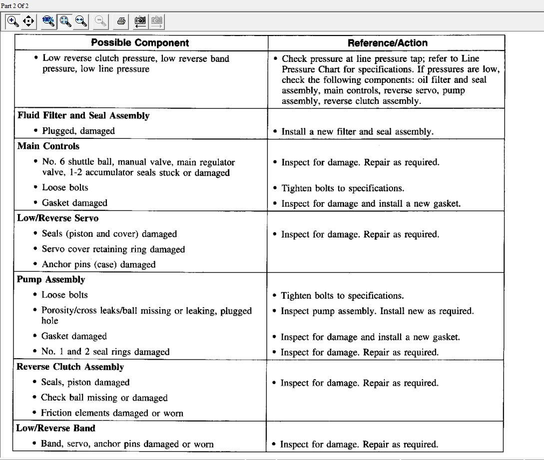

Here's the NO REVERSE (202 + 302):
Yes, push it in neutral or jack up the rear differential.
