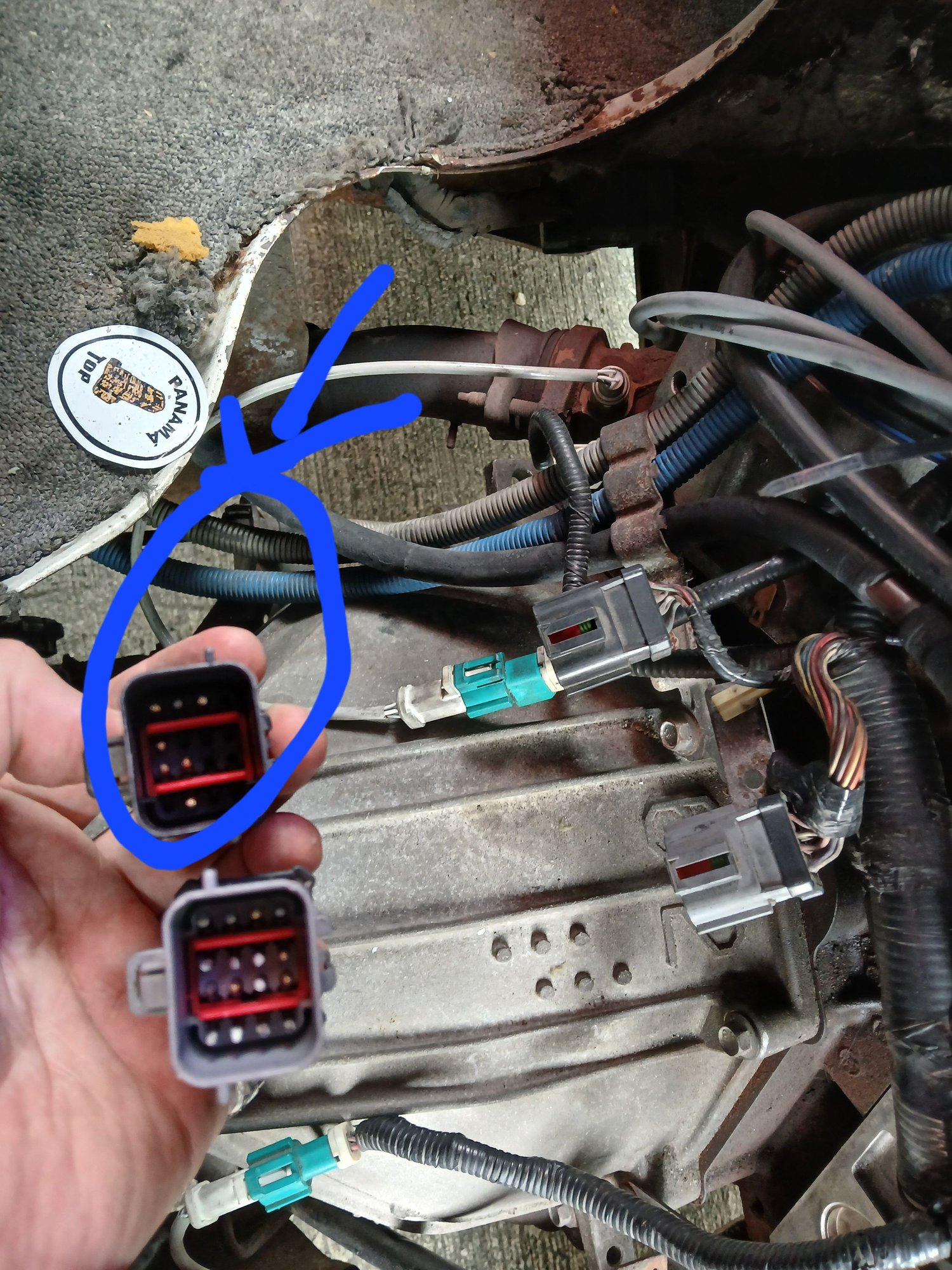

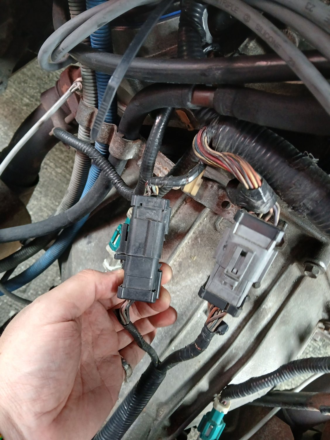

Hi, im facing a problem with my Ford E250 2002, because the engine start very well, but in 15 or 20 minutes it turn off sundenly, when i put a scanner it show the Dtc code PO161, that means the problem is located in the O2 sensor 2 bank 2, i Just chanched al the 4 oxigen sensors, i had take a look to the wires and found a issue with a kind of conector that i dont undestand very well , this is the photo,
i dont Know the name of the wire in order to replace it. Thanks for your time.

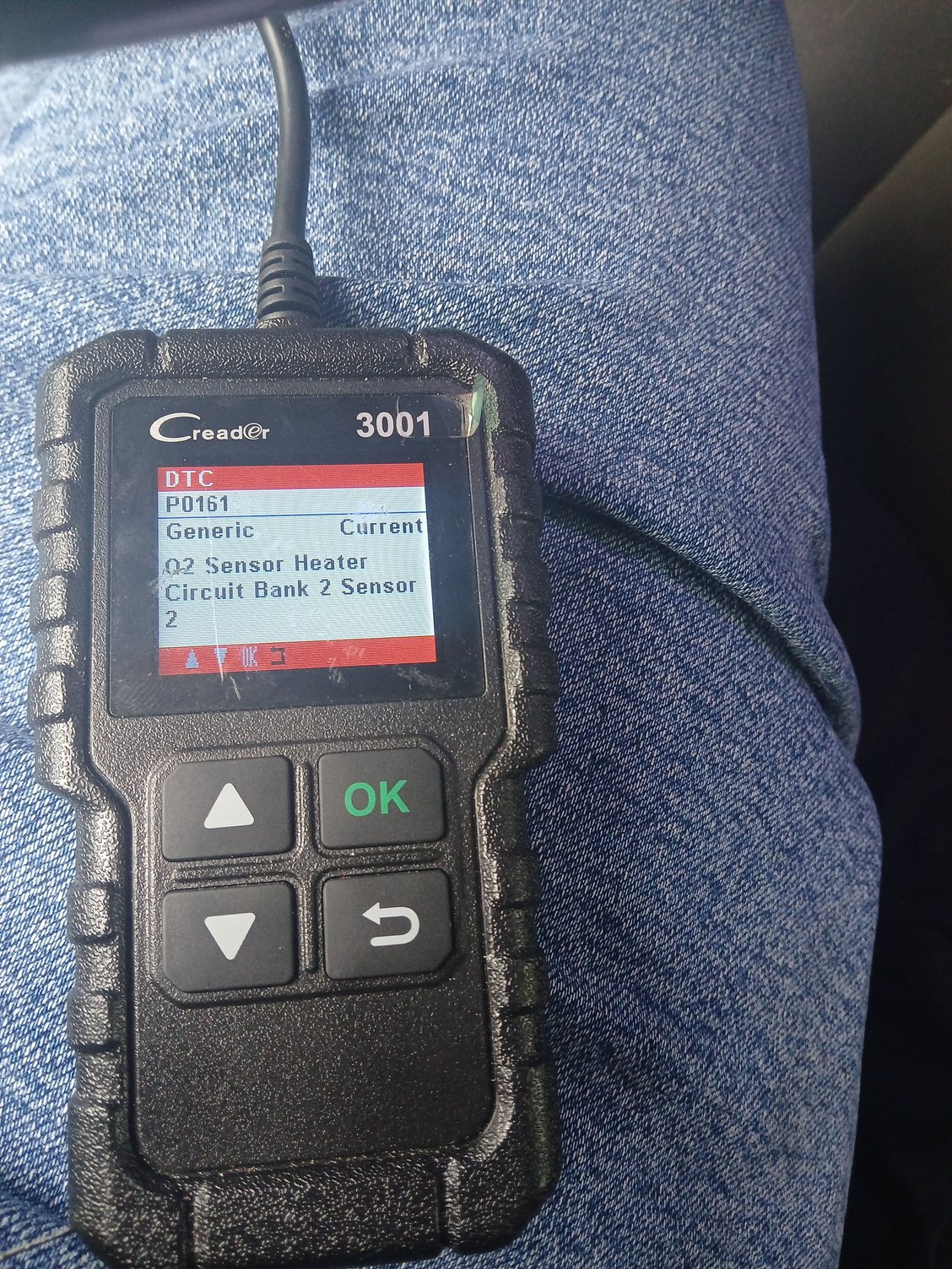

A: Its a 4.2 L, V6 . The van do restart well without a problem, once i got parked i set the scanner and inmediatly i got the code , plus i need to Know the name of the wire in the image because i think that i.need to buy and replace it , in the diagnóstic i got the message: "O2 sensor heater circuit Bank 2 Sensor 2"

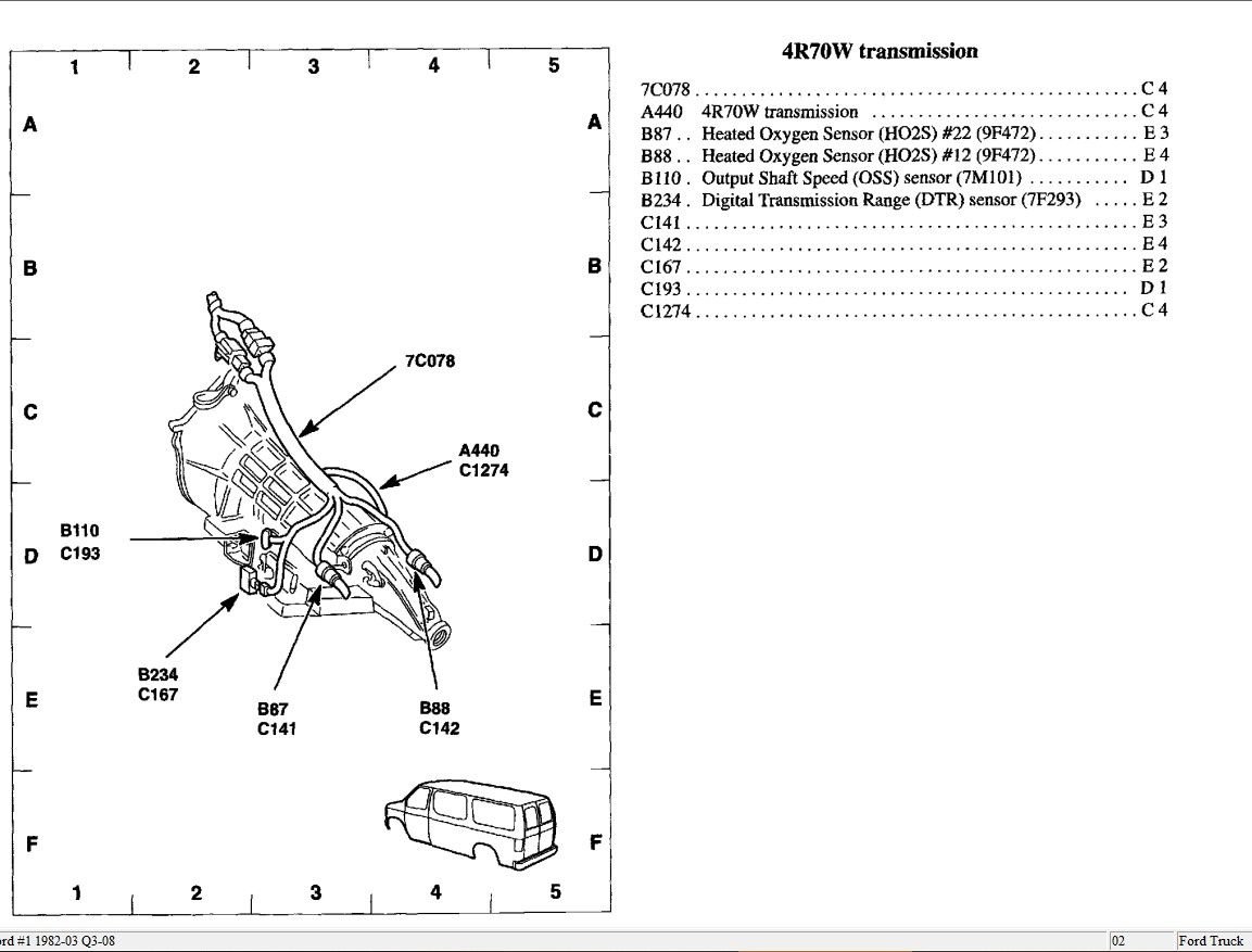

I assume you have 4R70W, let me know if you have 4R100 instead.
The connectors from your pic, you can't buy just that, if at all available, you have to buy the entire harness. I don't think you need to replace that at all.
What you should do, get "contact cleaner" and clean the C141, the 2 connectors in your pic you also clean them with contact cleaner.

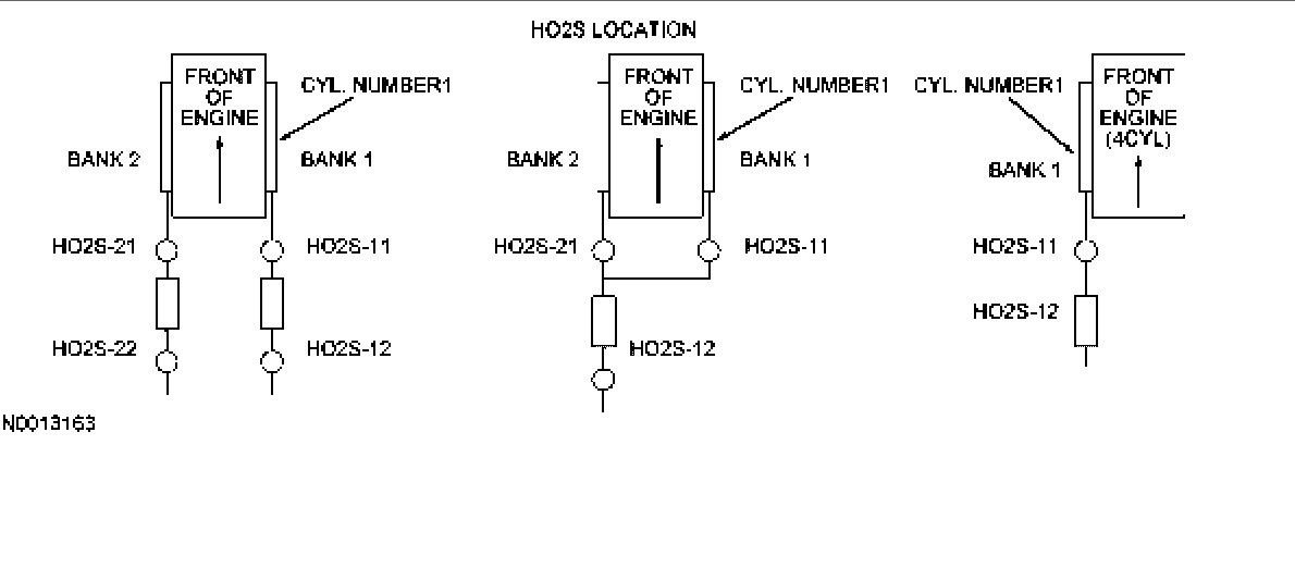

Frank,
Just to verify you have some idea of where you should be working,
Bank 2 is driver's side, sensor 2 is the oxygen sensor AFTER the converter.on that side..
With the key on, engine cold,you should have battery voltage at the red wire at the plug. Do you have it yes/no ?

That big connectors in your pic they have more than just your o2 sensor wires.

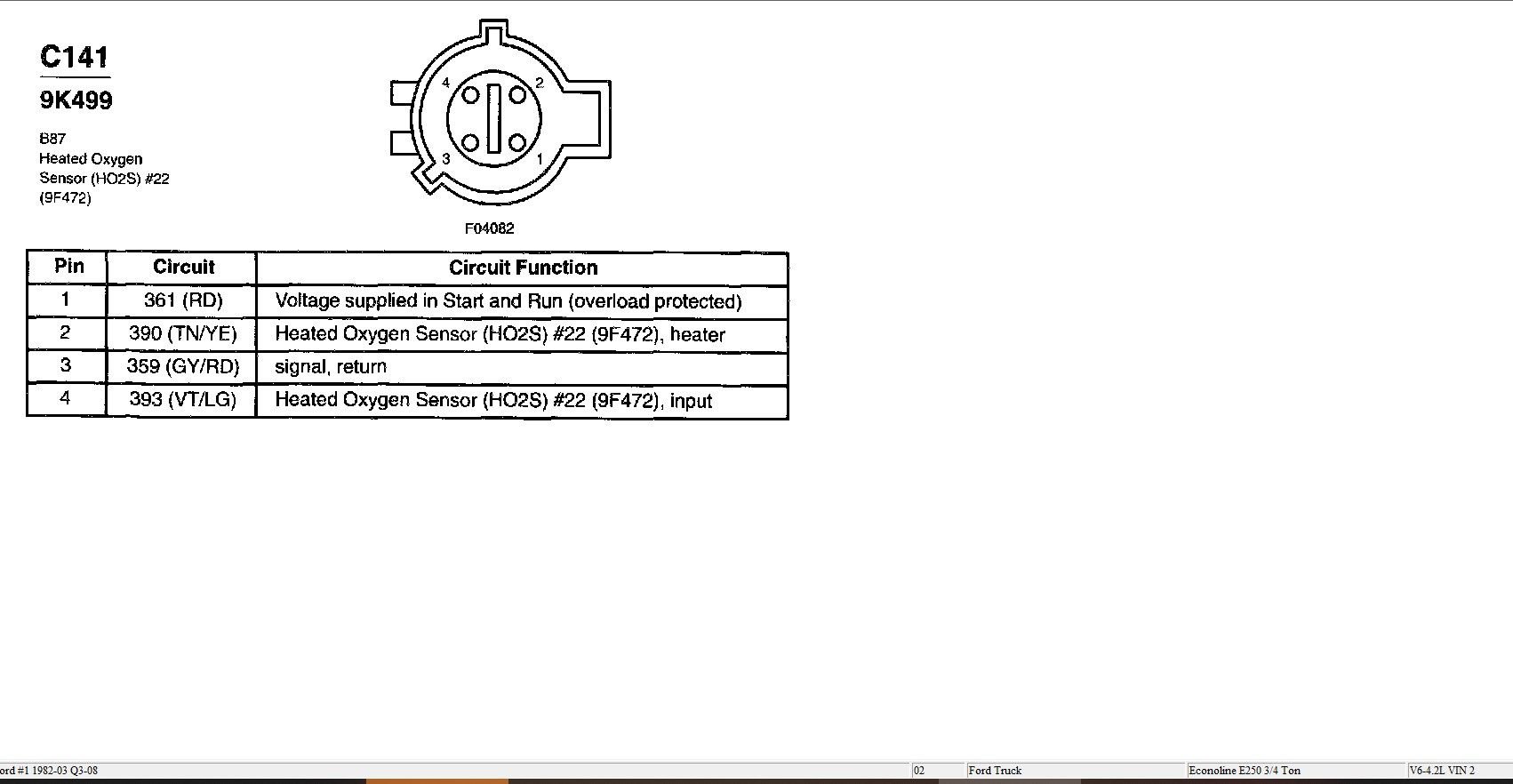

Look at circuit 359 (GY/RED) wire, that's the signal return wire from your o2 sensor.
