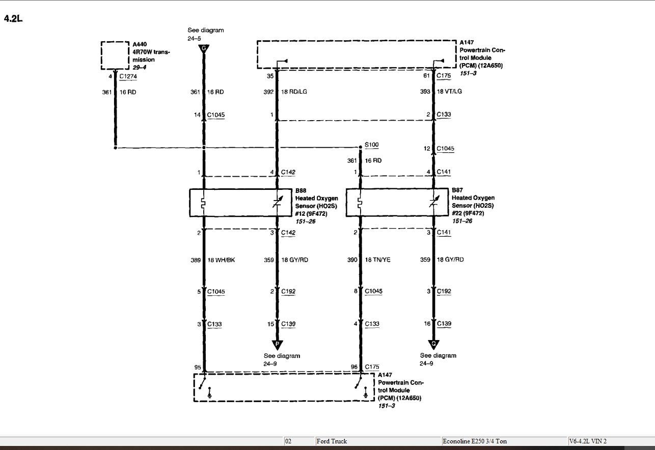

Originally Posted by heiko
Look at circuit 359 (GY/RED) wire, that's the signal return wire from your o2 sensor.
A/ i think its missing

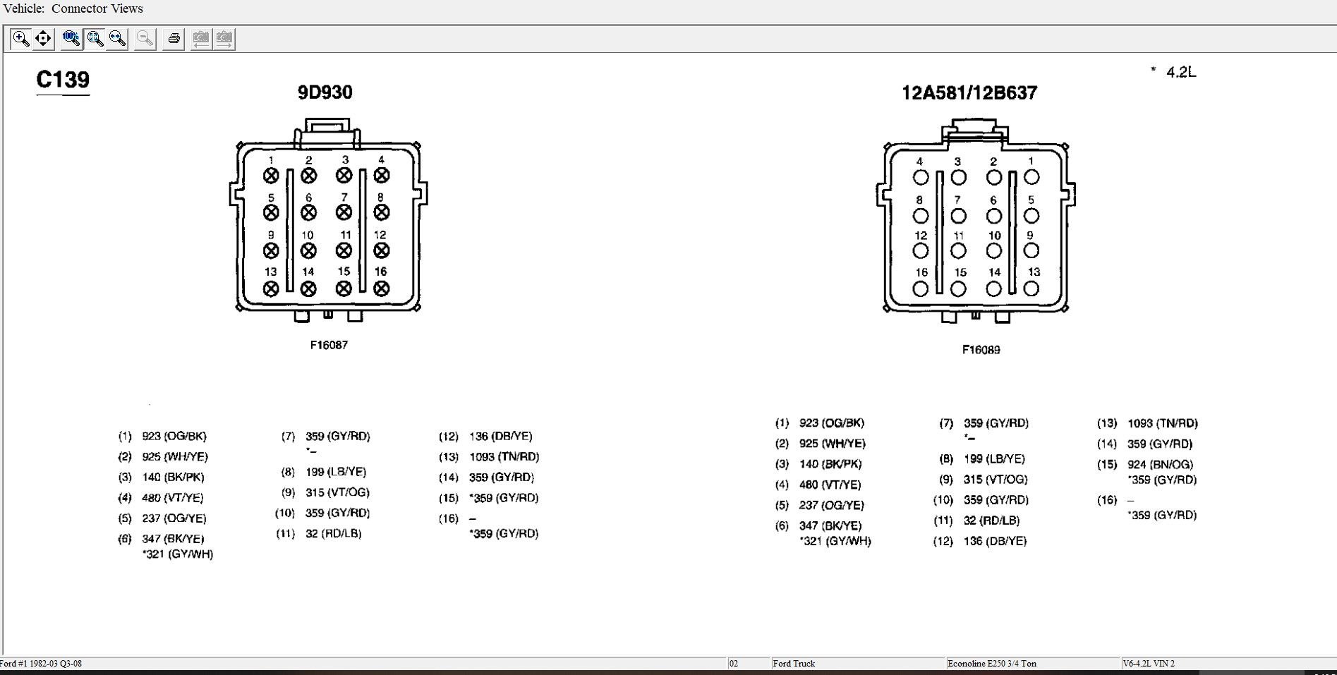

You are looking at the wrong big connector. You have 2 in your pic, the one without blue circle.
Also note on upper right corner of the diagram you see: * = 4.2L, so some pins for 4.2L only, some for other engine size. On the back of the connector you also can see the color. You can also do a continuity test on your C139 and C141 to confirm.

Posts: 1,229
Above is a section of the diagram I attached previously. Look at C139, on the left of it you see "16", so you look at pin 16 only. Even though you can see "GY/RD" wire at another pin, you ignore them, just look at pin 16 at your C139 connector. You can then disconnect the electrical connector on your o2 sensor (C141), test the wire at pin 16 of your C139 there.

On post #6 the diagram of the OXYGEN sensor connector section C141, the red wire IS the heater power to the sensor.
