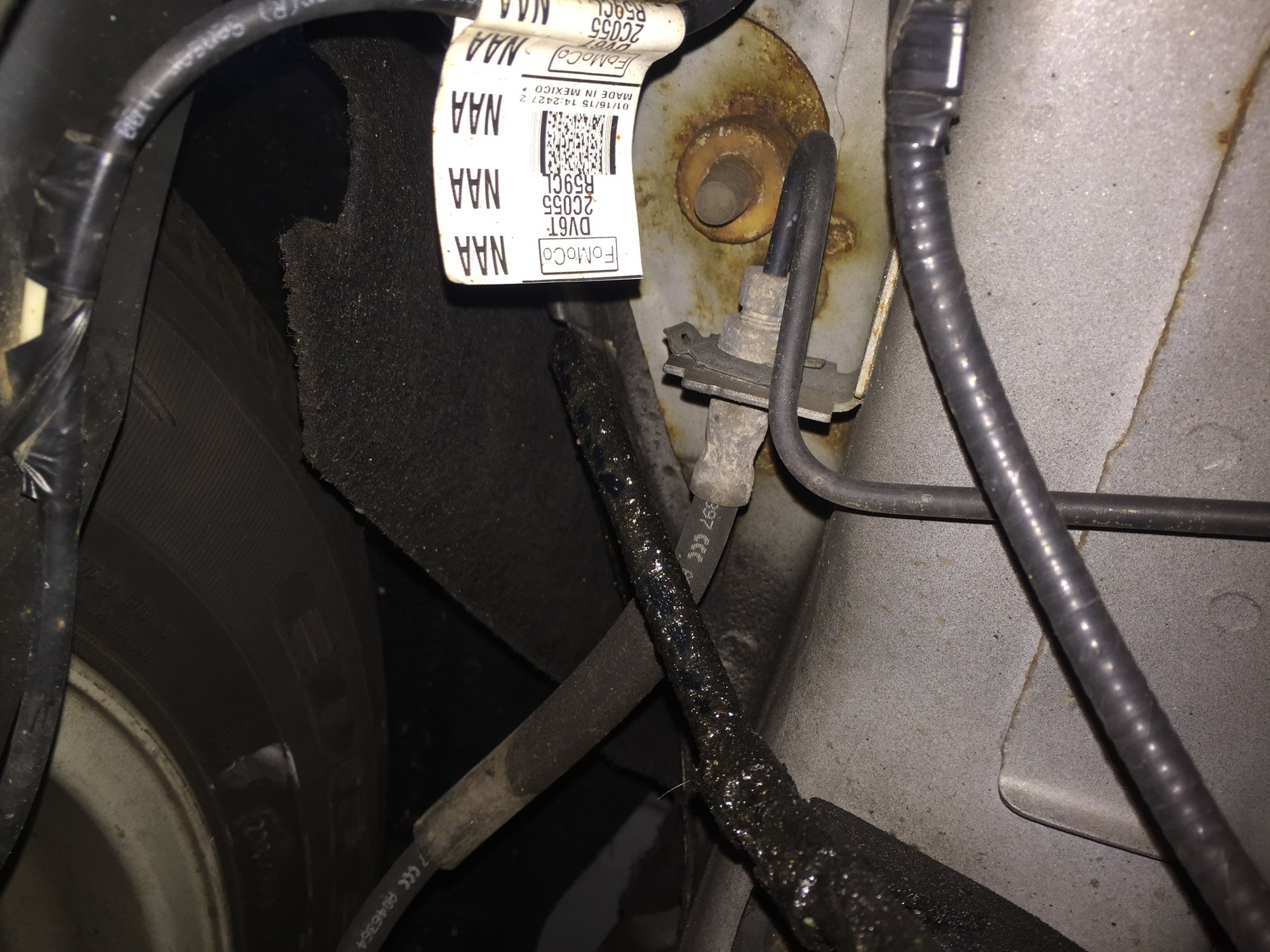

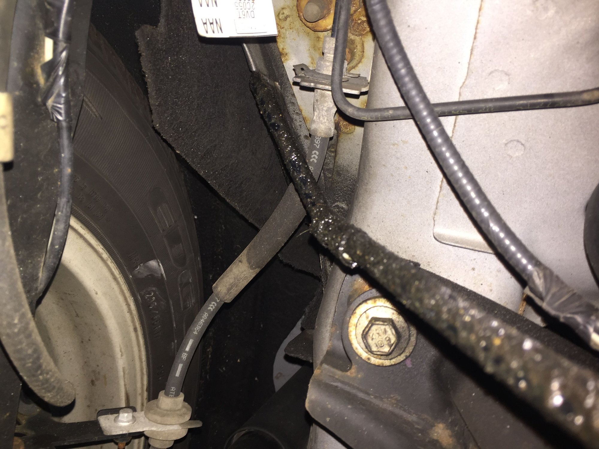

I have a small leak near my rear passenger tire. It’s on a line that I’m not sure what it is? Seems like that line is very wet and it seems dripping off that.
Old Jul 30, 2021 | 10:38 AM
scott.butler4's Avatar
Joined: Apr 2020
Posts: 1,077
I see a what looks like a wiring harness that is wet, but I also see what may be leakage from the brake hose.
Do you have all wheel drive? Can you tell what type of fluid it is? Can you make the fluid come out when looking at it?

It’s the intelligent 4wd and it’s a light brown color. It left a marks on the driveway too. It’s only the line/hose that’s wet and it drips at the bottom part. Smells little like alcohol.

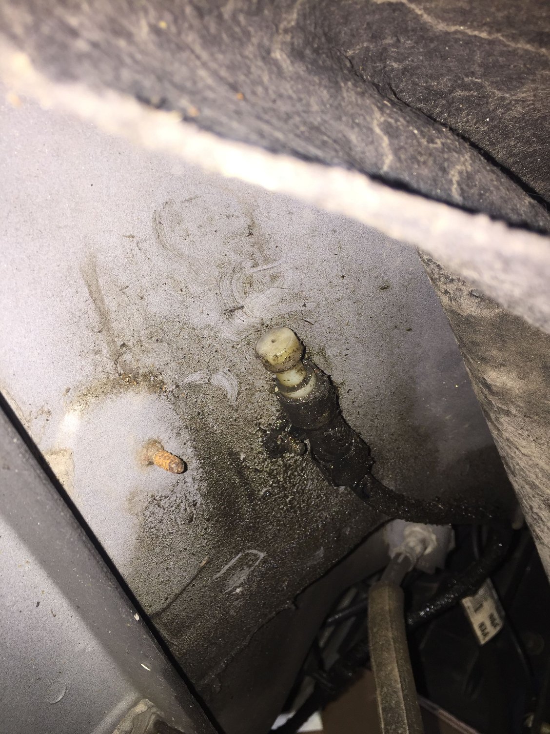

Actually I think I found where it’s leaking from. I took off the padding area around that tire and found this. Do you know what this is and why it would be leaking. I followed that line and it lead me to here.
Old Jul 30, 2021 | 10:12 PM
Joined: Apr 2020
Posts: 1,077
That looks like a breaker tube, due to the fact you have all wheel drive I would bet thats the rear diff breather.
My recommendation would be to jack up the rear, locate the other end of the tube that connects to the diff, disconnect it and blow the hose out with compressed air to clear any blockage.
Also a not a bad idea to check your rear diff fluid level.
