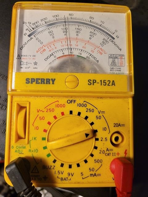

OK...so I pulled the connector off of the sensor and checked the two things mentioned above to look at.
In the first picture you can see that there is a hair over 4 VDC on the one line.
In the second picture you can see that there appears to be a dead short to ground on the other line.
I wiggled around all of the wiring bundles I could find, hoping that I would see the resistance drop at least momentarily so I could get an area to focus in on, but unfortunately the meter never wavered off zero resistance.
I'm afraid that I'm getting to the end of my technical abilities and that I may need to take it some where to find the short.
