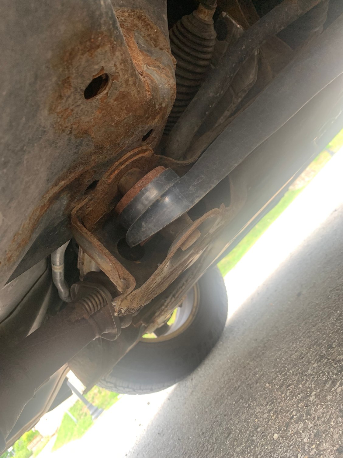

[QUOTE=cjr2011;128693]I have a 2011 Ford Escape with the same problem! My subframe (K-Frame) rusted on my passenger front and snapped at the weld and then snapped my front axle. I have no money in which to purchase another vehicle/ fix mine ( had to have it towed to an independent mechanic ) He told me it will be about $1,600-$2,500 to replace the subframe and put in a new axle. No one wants to address this issue because there is not an active recall. I called and made a
Wheel completely detached from the sub frame and axle
Snapped axle
Rust on passenger front sub frame at the weld where it snapped
complaint and I think that anybody with a Ford escape needs to go and have it looked at but also make a complaint about the sub frame. This needs to be addressed it needs to be recalled and the people that have had the issue should get it fixed for free.
