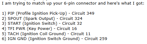

I'm back. Thanks heiko. I WILL just follow the circuit numbers. And big thanks for matching up the output pins for me
All this was/is an attempt line up all the material needed to relocate the TFI on my Escort to a cooler location.
I just went through another TFI 'failure' R&R, only to discover that the TFI was "good", and when placed back on the distributor (as a test) proved to be completely operable. The distributor itself was replaced (along with a new PIP, about a year ago). I hate these things...
