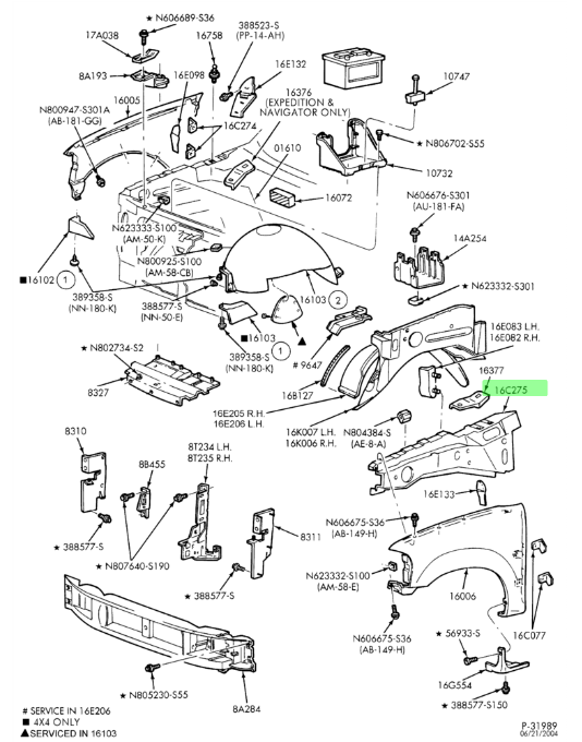

I have a 1997 Ford Expedition XLT and my brother wrecked it. He rear-ended a brand new BMW. Now I have torn into it to fix it I have all the new parts that I need. But I ran into this issue. The radiator support is bent and now I have taken my Fender off and I realize the panel behind it is bent. It has Twisted the front end of the truck and the door hits the fender now. Only on the driver side I cannot figure out what the name of this panel is. I know you have to cut it out and weld a new one in. But I need help I don't know where to find this part and I do not know what it is called. Here is a picture.

I have some information and some bad news on this item. I found the part, it is part number F75Z-16C275-AD. We don't have it listed on OEM Ford Parts & Accessories | Lakeland Ford Online Parts because it is obsolete. I did a nationwide search for the item and unfortunately not one dealer in the USA shows the item. I have attached a diagram for you that may help you break one down at the salvage yard. I wish I could help more.
