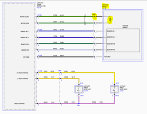

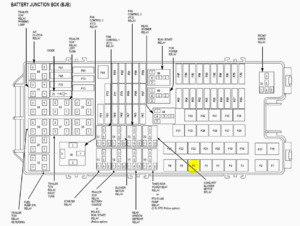

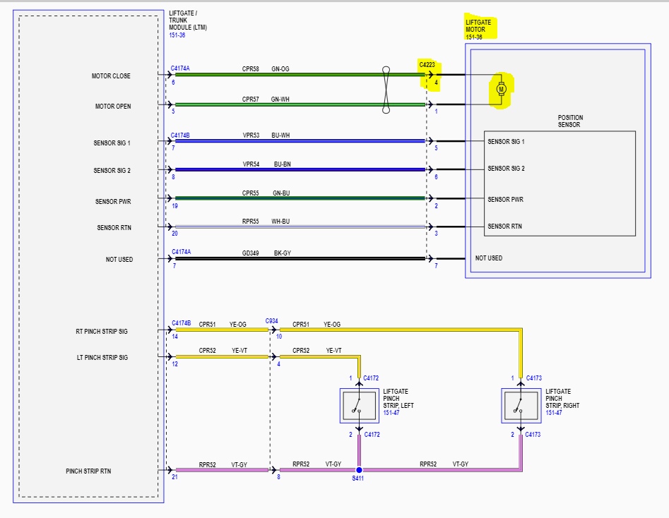

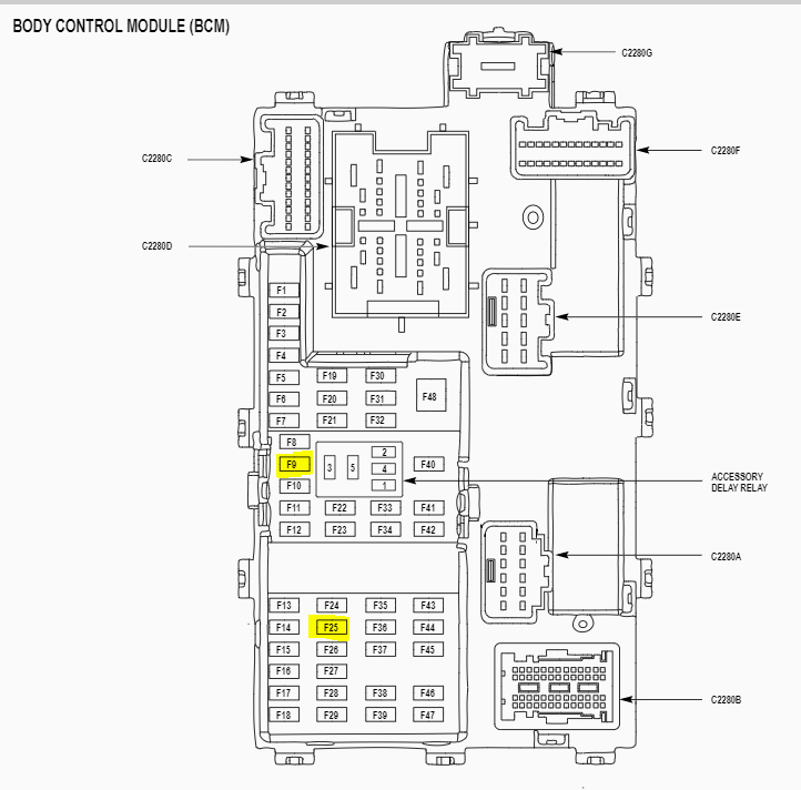

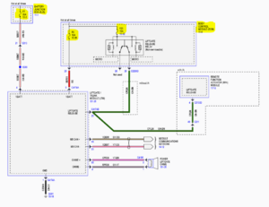

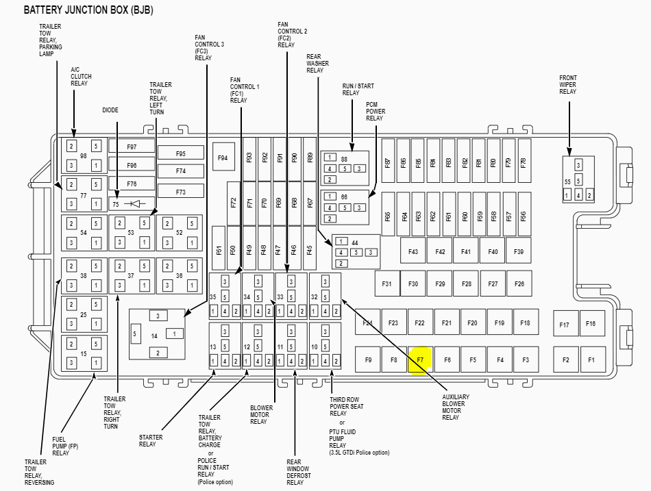

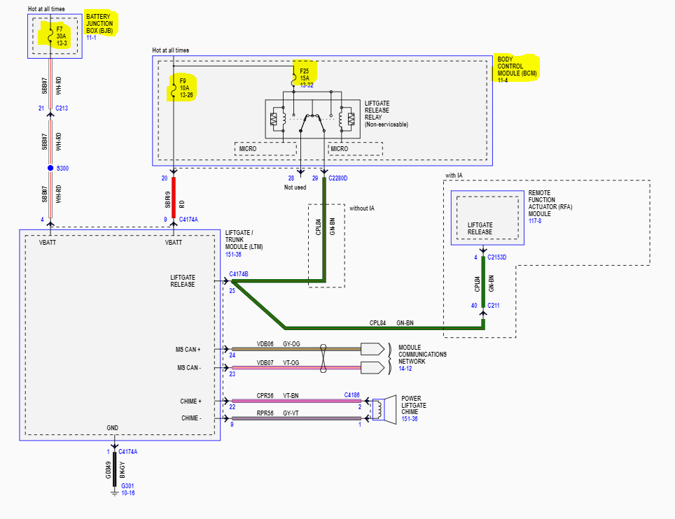

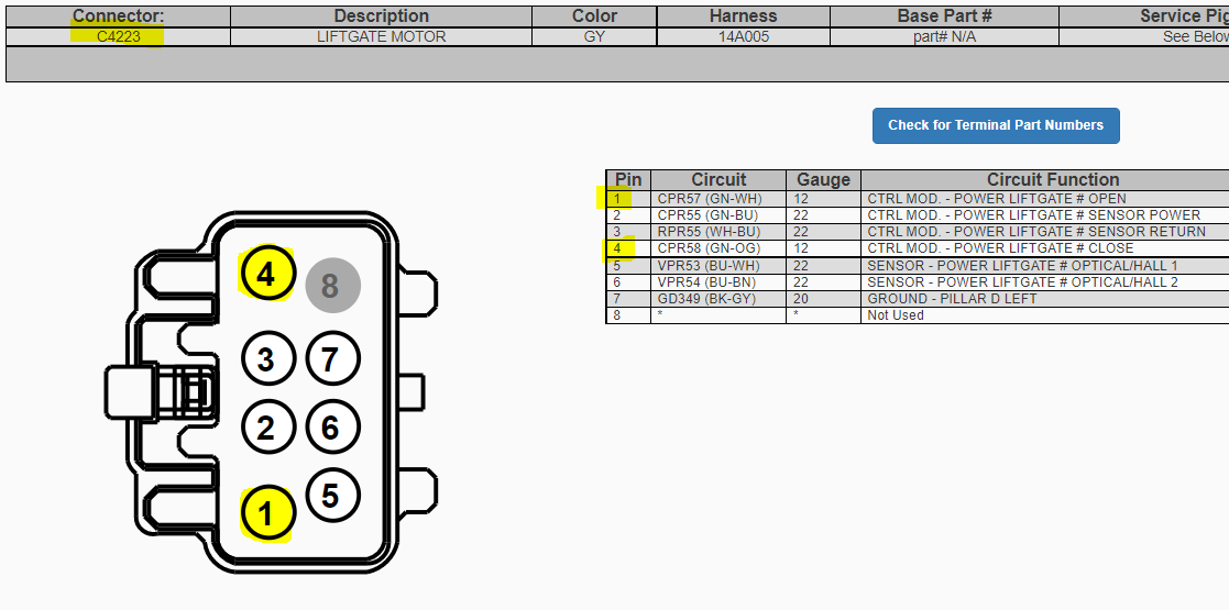

OK here is the wiring diagrams that you can use. Check the highlighted fuses to start, then disconnect the liftgate motor and check for voltage between pins 1 & 4 when the liftgate button is pressed.
