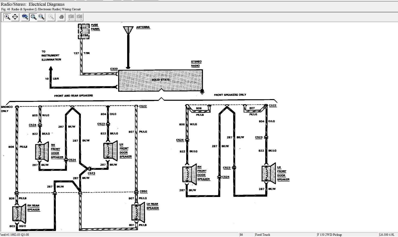

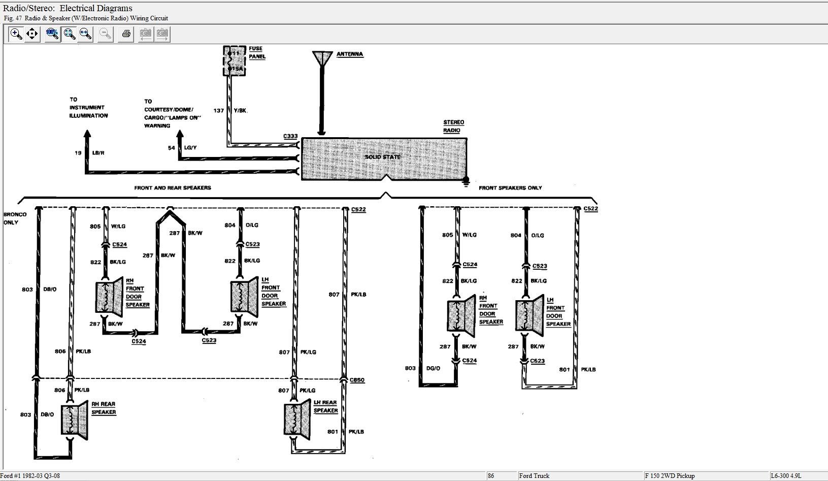

Old Oct 7, 2024 | 07:45 PM
Posts: 1,267
With electronic radio above.
Without below:
