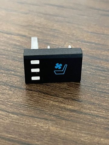

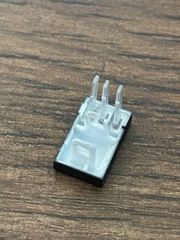

Hi everyone,
I recently bought a used 2019 F-150 Lariat that has heated and cooled seats. However, when they cleaned the car they didn't do a great job and the passenger side seat cooler button would get stuck and was difficult to get unstuck so that the seat cooler wasn't permanently on. When I was trying to clean it last night, the button popped off which was fine, but when I was cleaning it with some warm water, a small piece of the plastic broke off. I've been trying to track down a replacement, but it has been nowhere to be found on the ford parts website. Does anyone out there know what part number it may be perhaps? Or where I could order a replacement?
Thanks.
Front view of the button that is from the passenger side
Right piece of plastic that broke
Another angle of the piece of the plastic that broke

Your gonna need a whole new climate control panel.
The buttons are not available separately.

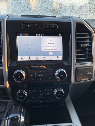

Thanks and that is what I was afraid of. Here is a picture of the panel that I took this morning.

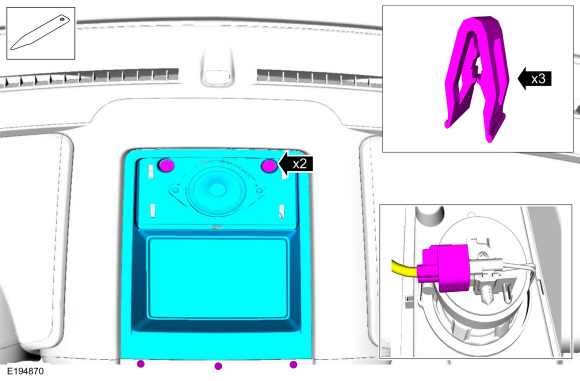

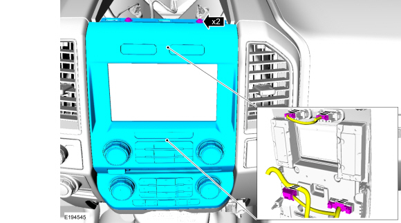

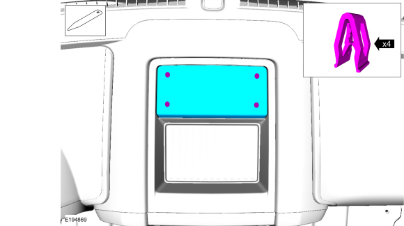

OK so I believe it is called a "Front Controls Interface Module"
I do not believe the HVAC portion is available separately.Removal
NOTE: Removal steps in this procedure may contain installation details.
  1. NOTE: If installing a new module, it is necessary to upload the module configuration information to the scan tool prior to removing the module. This information must be downloaded into the new module after installation.
    Using a diagnostic scan tool, begin the PMI process for the FCIM following the on-screen instructions.
  1. Release the clips and remove the instrument panel speaker grille.
    Use the General Equipment: Interior Trim Remover
  1. Remove the bolts, release the clips and remove upper instrument panel storage tray.
    • If equipped disconnect the electrical connector.
  1. Remove the bolts and the FCIM.
    • Disconnect the electrical connectors.
Installation
  1. To install, reverse the removal procedure.
