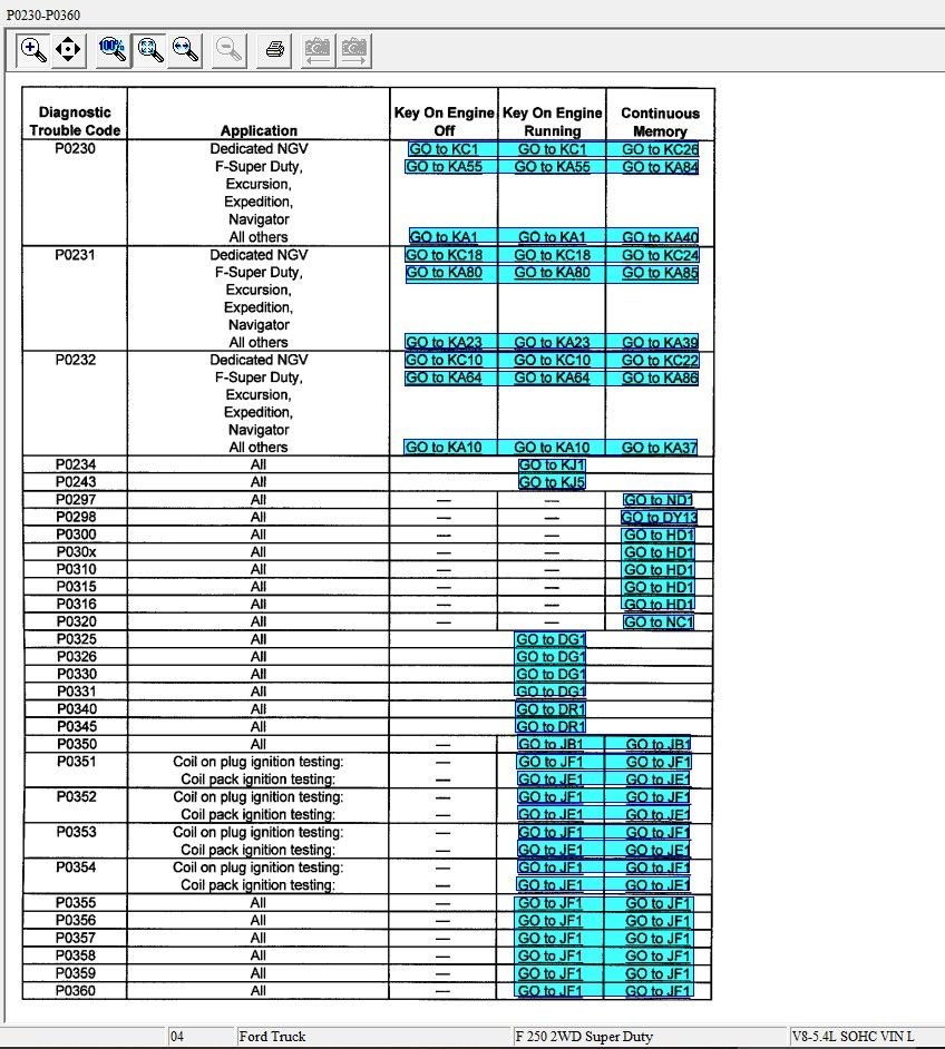

For P0308 check Pinpoint-HD.pdf below. You'll be asked to check H and Z as well.
P0174 check Pinpoint-HA.pdf below. Also check DC, HB and A.

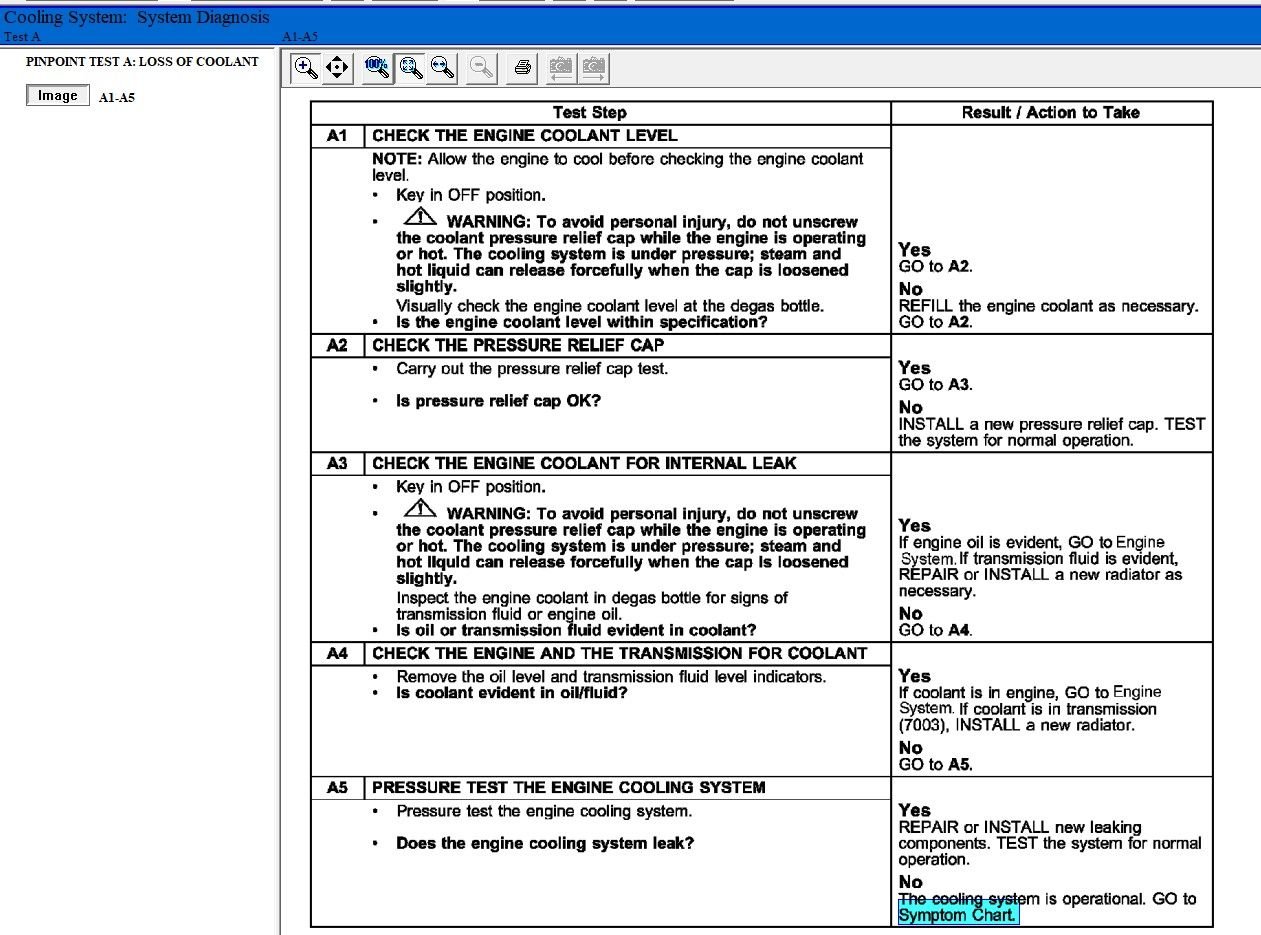

You should also remove (no swapping just remove) # 1 and # 4 and see if any coolant there as well. As you should know by now you probably have a bad intake manifold gasket. If you have leaks near the heater hose then your # 5 shouldn't have coolant there.

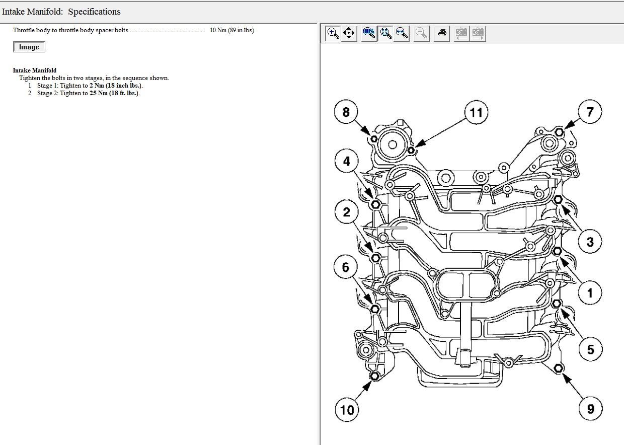

If you have internal leak after pressure test check the intake_manifold pdf below.
