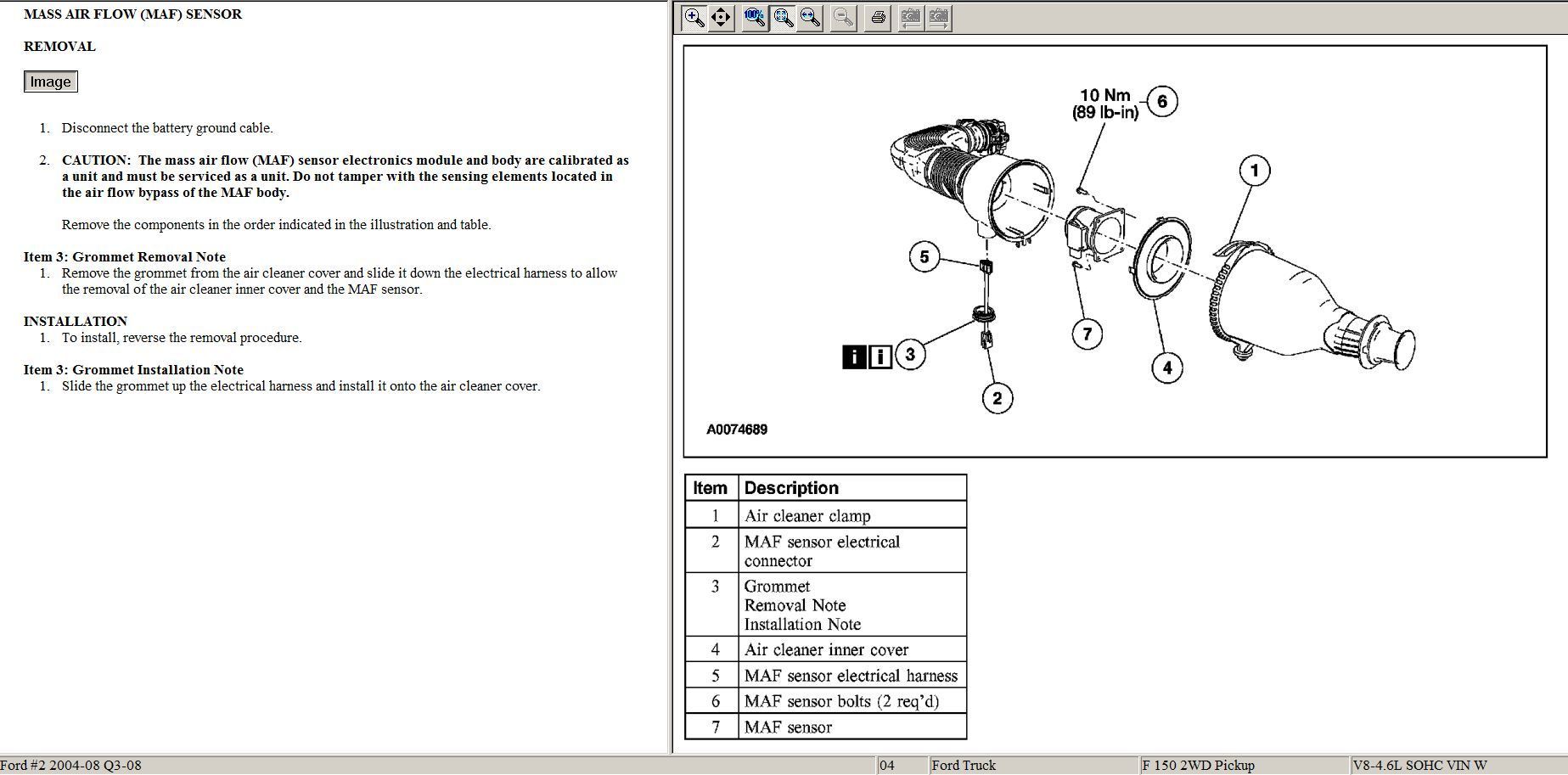

Symptoms like yours first thing you check is MAF, not coil pack and not fuel pump.
1) Next time it stalls again pull your truck over and pop the hood and key out
2) Locate the MAF's electrical connector and unplug it, don't need to disconnect battery ground cable. When MAF is present but not connected, default fuel trim ratio will be used.
3) Key in, restart and drive
You should get rough idling still, but your engine shouldn't stall again and you should be able to continue your trip. If that's the case, more than likely a bad MAF or its bad/dirty wiring.
