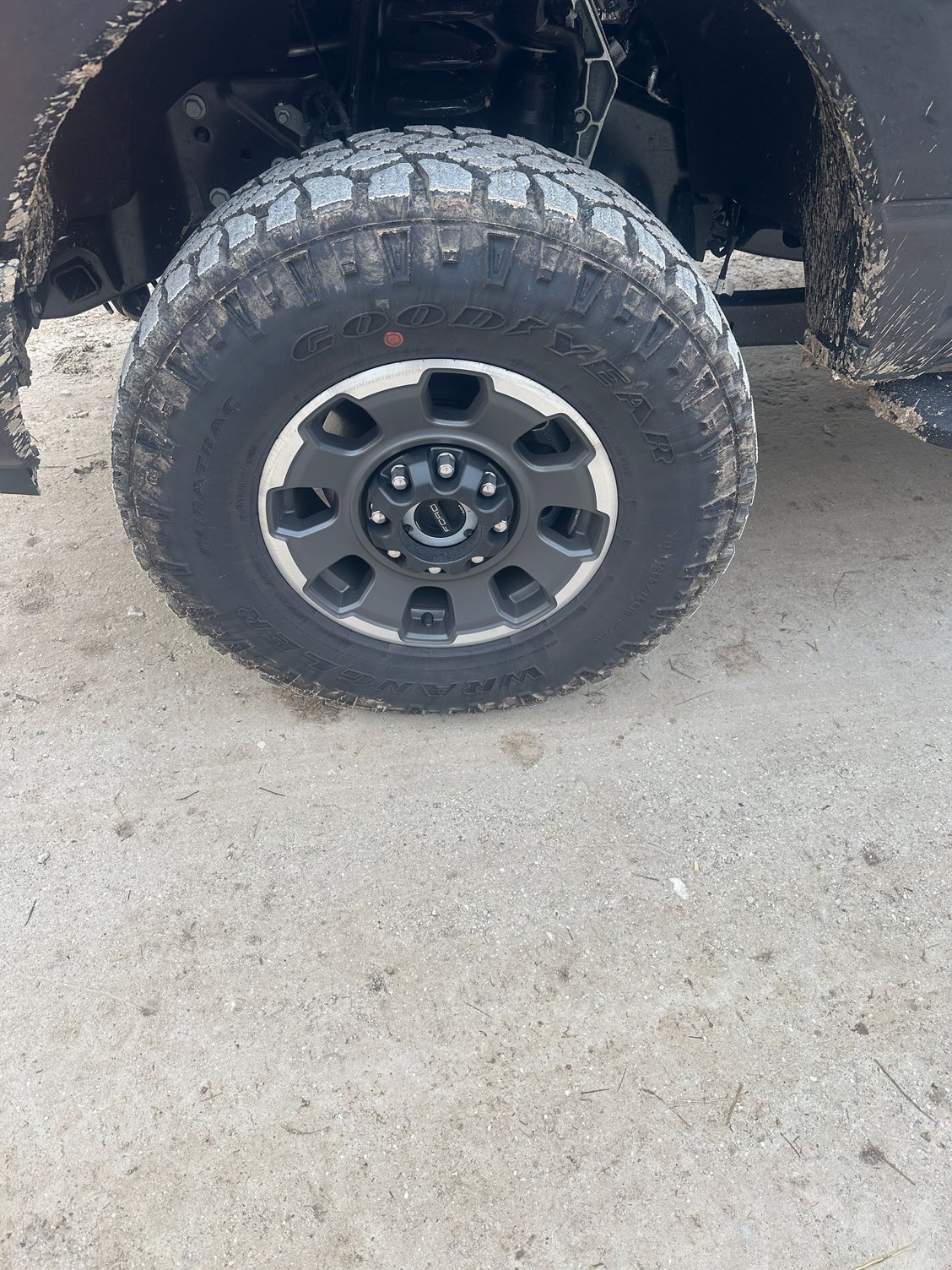

Just bought our first Superduty a couple weeks ago and hauled our horse about 2000 miles-was great.

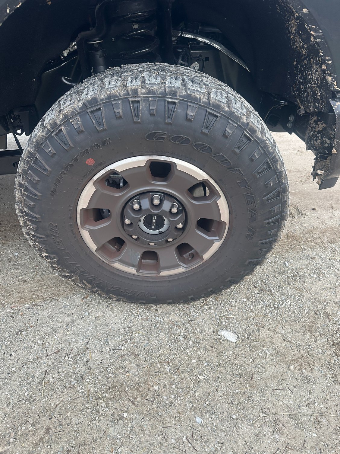

i noticed lots of brake dust on the front right wheel only. It has been consistent.
The caliper/wheel does not get hot. It does not pull to that side while driving or when braking. The brakes feel as though they are working properly. No warnings. I’m unable to get it looked at right away.
What do you think might be causing this?

In the posted pix, that red dot on the tire is supposed to go over the valve stem when mounting,somebody goofed along the line.
Pad material may not be quite the same , not unusual.
I wouldn't be too concerned regarding dust material, but it still won't hurt to have the dealership check why the difference..
