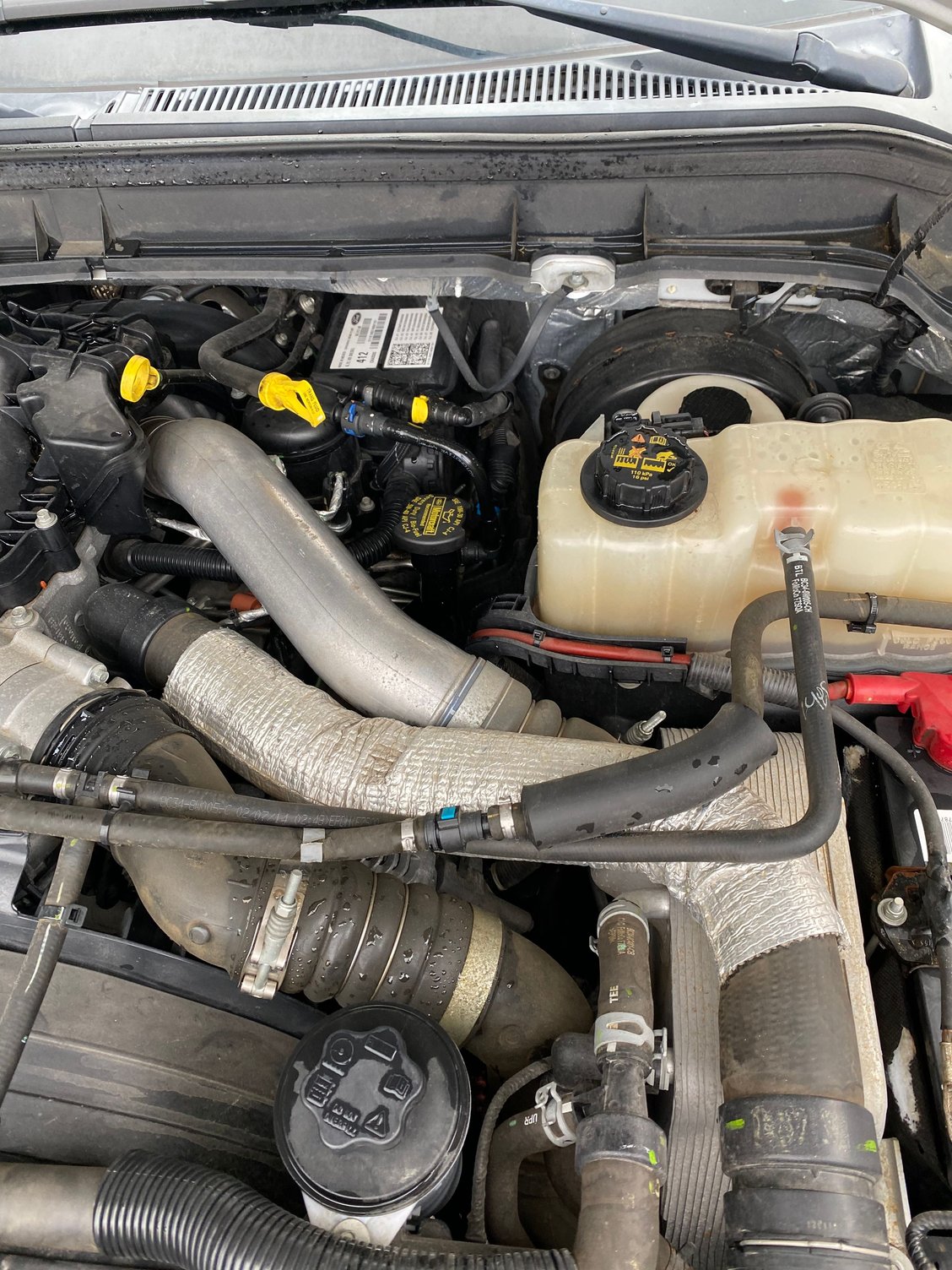

Oil leaking from the 2.5” to 3” tube that goes from the front driver side to firewall. The seepage is coming from the firewall side. Can anyone tell me what this issue is and what could be causing it
The top pipe closer to the firewall is where I’m seeing the small leak at the connection area

Any smoke problems when starting the engine?
Appears those are turbo to engine intake ducts, if so you didn't provide year of vehicle and some had problems with oil accumulating in the intercooler. Suggest you consider having dealersrhip check that out for you.. They would have access to latest info on that.

Thank you for the response after doing a little further research online I found that the problem may be the crank case ventilation system for the 2014 F250 diesel I see that there is a CCV reroute modification that would solve my problem and help the engine overallAny further input on others experience with the CCV reroute get would be appreciated
