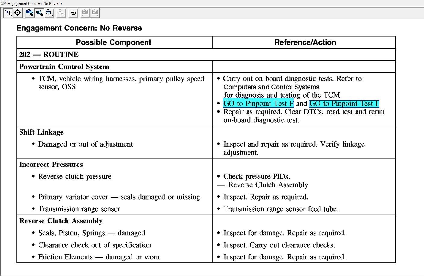

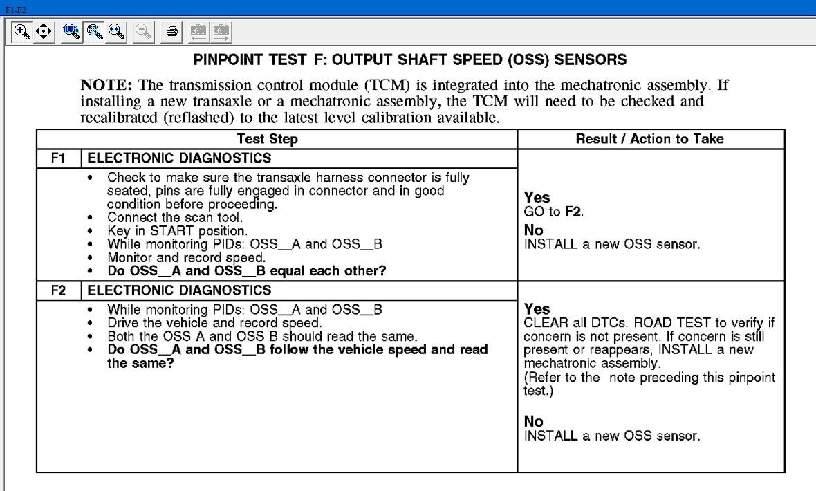

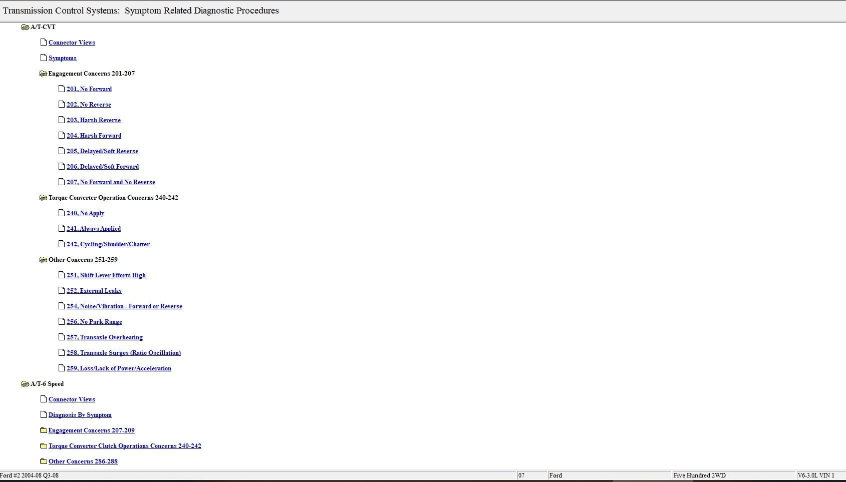

Possible causes for A/T-CVT shown above. To go thru the 2 pinpoint tests above you need a capable scanner like Foxwell NT510 Elite w/ Ford+Lincoln+Mercury software.

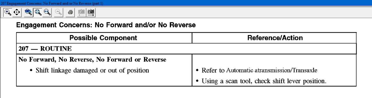

A/T-6 Speed shown below:
The Routine 207 shown above saying "Refer to Automatic Transmission/Transaxle" -> Shift Linkage takes you to download the 2 PDF attached below.
