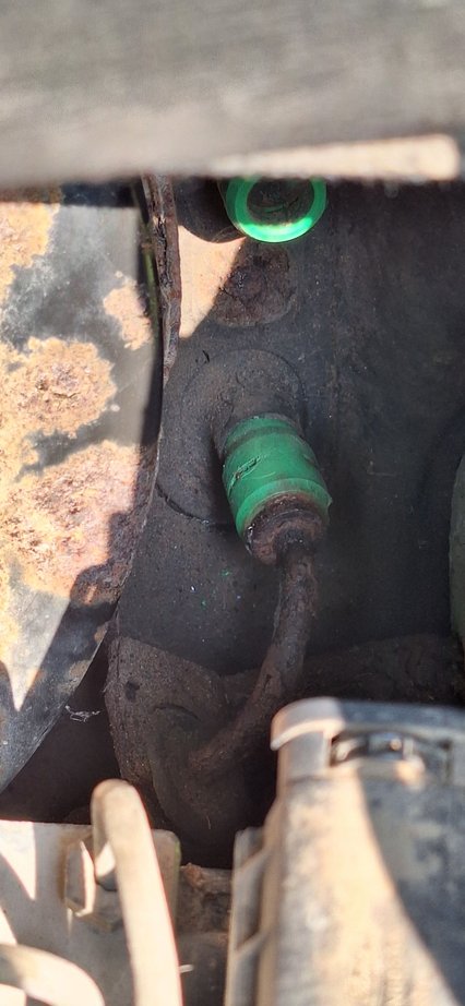

I have a 2000 Ford Focus ZX3 with a manual 5 speed transmission and am having an extremely hard time finding a part. The line that goes from the clutch master cylinder to the top of the tranmission has sprung a leak in the upper part of the hose. I called the dealer and he said that part is obsolete. Tried calling numerous salvage yards with no luck. Any help locating this would be greatly appreciated .

Things you might consider,
Vintage Parts inc 1-877-846-8243
any business that makes hydraulic hoses for construction equip might be able to make a new one for you, but may need the old line to see the fittings required.
That is not the only year and model that had a hydraulic clutch system. If you bring the old one to a dealership or good auto parts supply store, they may be able to come up with a close match.
