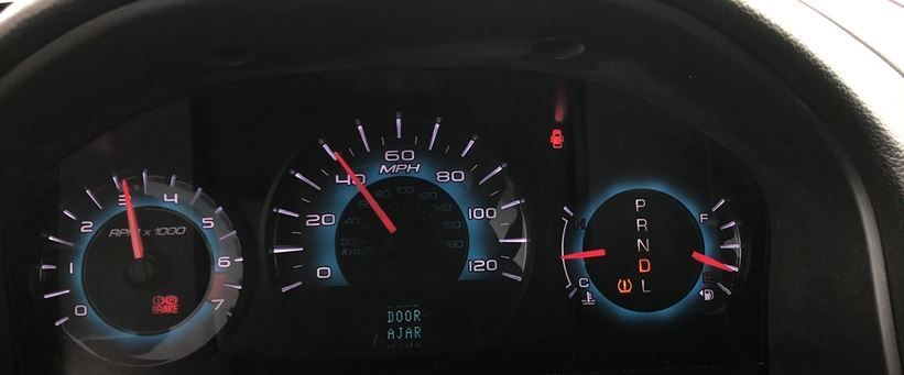

A few weeks ago, while driving, my car chimed, as if I had a door open. The instrument cluster showed a (!) light, parking brake, and a door ajar light. In the information display on the instrument cluster, the TIRE PRESSURE warning displayed, as well as the DOOR AJAR. At the same time, my information display (Time) went out, as well as my radio sound, and climate control functions (No AC). While driving, everything went back to normal again. This has been intermittent on and off now for weeks.
I pulled the Smart Junction Box (SJB). It was not wet, no corroded connections. I replaced it with a junkyard SJB for the same year, make, model, and trim. Same issues after I replaced it.
Other variables:
-I just had my mechanic replace a sensor to get my AC working again, this was about 2 months ago. Also had to swap aftermarket stereo out for the factory one after my mechanic dropped my aftermarket stereo.
-I also have a remote starter with questionable wiring (purchased this way).
ANY IDEAS? Thanks!!

I had this exact problem on a 2011 Escape and could not find any solid advice to correct it... until now. The low tire pressure, door ajar and emergency brake indicator lights on the instrument panel would light up intermittently. The warning beeper would chime, dash signal indicator lights would stop working, radio volume would decrease and A/C would stop working. This drove my wife crazy and I thought I would have to scrap the car since I would not be able to sell it in that condition.
The following solution saved my car from the scrap yard. The dashboard cover above the instrument cluster can be removed to provide access to the electrical connector at the top right side of the cluster. Reseating this connector solved the problem.
