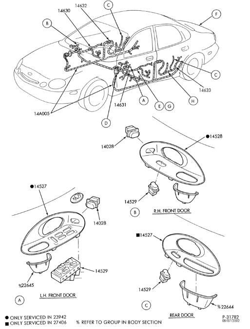

Take a look at the diagrams I have uploaded. They are the Ford diagrams, maybe they can offer some help.
Attached Thumbnails 2003 Taurus passenger window will not  roll up-wiring.png   2003 Taurus passenger window will not  roll up-wiring1.png

Thanks to both of you for your replies. Even though we had tested everything and had "power" it does seem to be a bad diode in the switch - probably drivers side switch. We were told by a different fellow that just because the motor & switches work hooked up to a power source, doesn't mean it will perform under load. To be safe we changed both switches before even attempting to roll the window down and up - it worked! Again thanks for the help.
