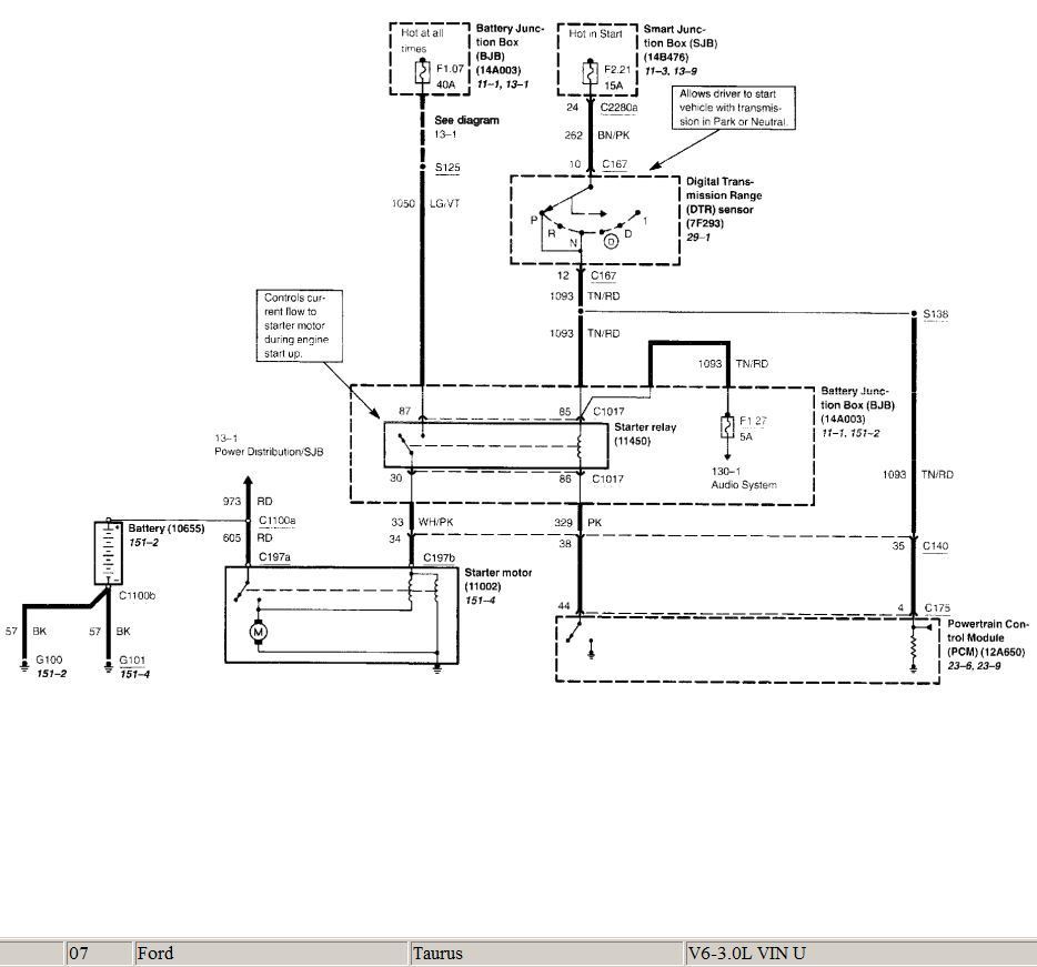

Posts: 1,278
If your PATS kills starter only then you can bypass it.
1) Locate the S terminal on your starter solenoid, it's attached to the starter motor as shown below:
2) Do NOT use a screw driver and jump the B+ and S terminal, instead, get a battery jump start cable, one end of the red alligator clamp to the S terminal of your starter solenoid (black is not used)
3) Turn your key to ON or RUN position
4) The other end of red alligator clamp to your battery (+) post
What do you get?
- no crank no start (find a locksmith)
- crank no start (find a locksmith)
- crank and start (PATS bypass is possible)
If the bypass is possible, you need to ground either terminal 85 or 86 (Ford loves to use non-standard relay schematic) at the starter relay then you can setup the bypass permanently.
I don't have any electrical diagram for your vehicle, can't give you further details. But look at below diagram for a 2007 Taurus:
In this case you just need to:
1) depin or cut the PK (pink) wire that is attached to pin 44 of your PCM (you don't mess with the PK wire that's underneath the starter relay at your battery junction box (BJB))
2) attach this PK wire (the end from the BJB) to a good ground source permanently
