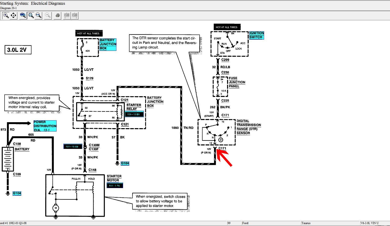

You said you got 12.38V at terminal 86 (with relay removed), let see if your TN/RD wire is bad or not.
This time you jump from the other end of the TN/RD wire at your range sensor without removing the range sensor (from the red arrow above) to the TN/RD wire from underneath the relay panel that you did earlier (without removing the relay), then turn your key to start.
You need the following:
Without removing the connector at the range sensor, insert into pin 12 as shown below:

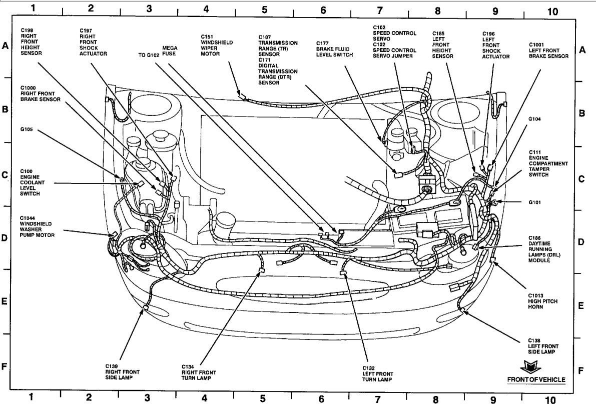

Below diagram locate C171 (range sensor):
The test above is to add another wire (your jumper wire) to your existing TN/RD.
