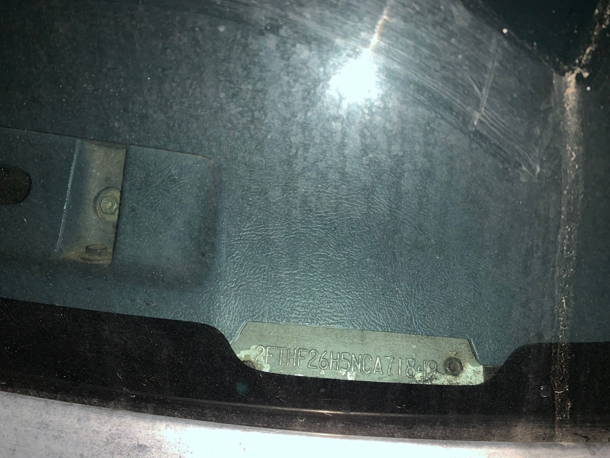

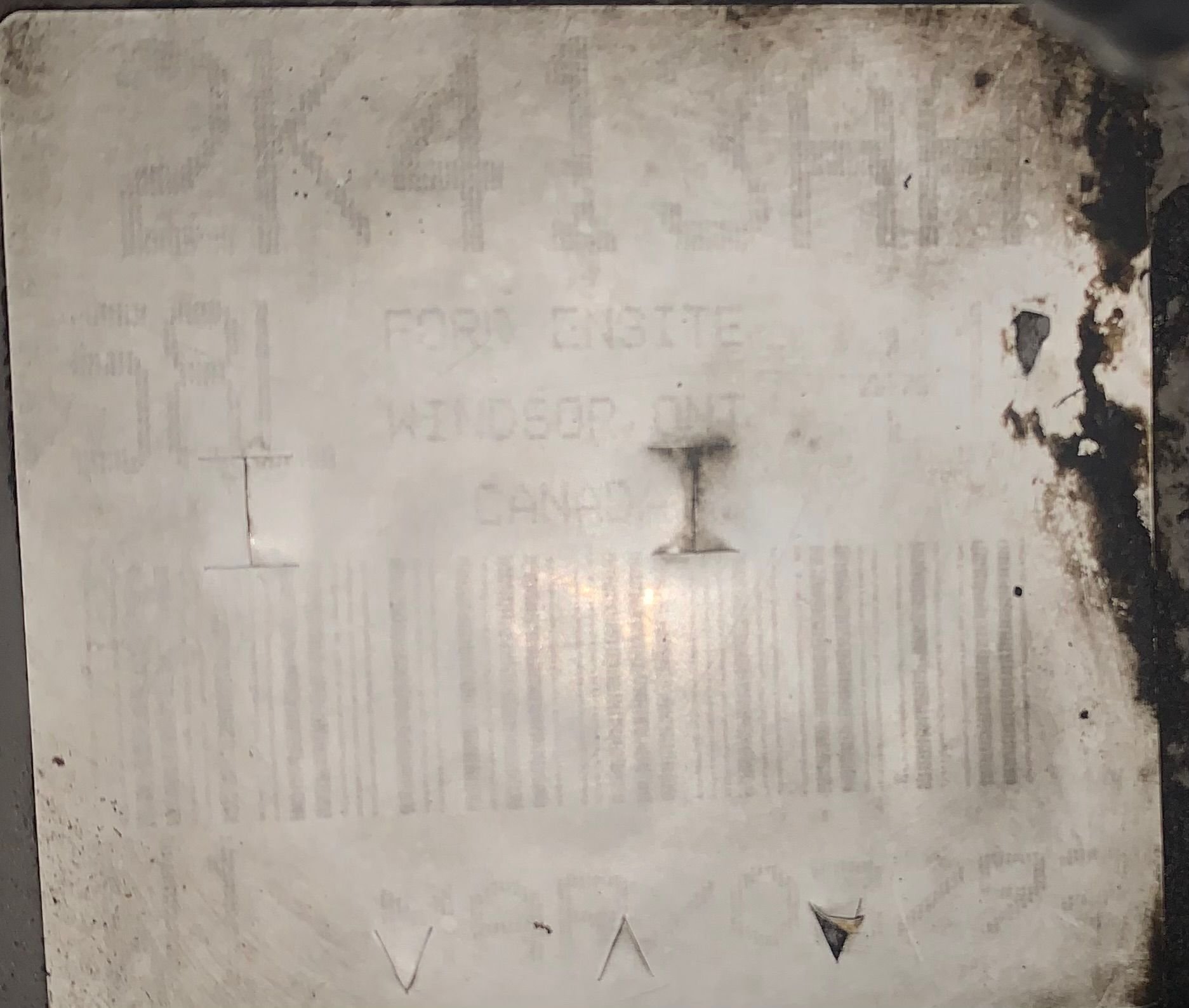

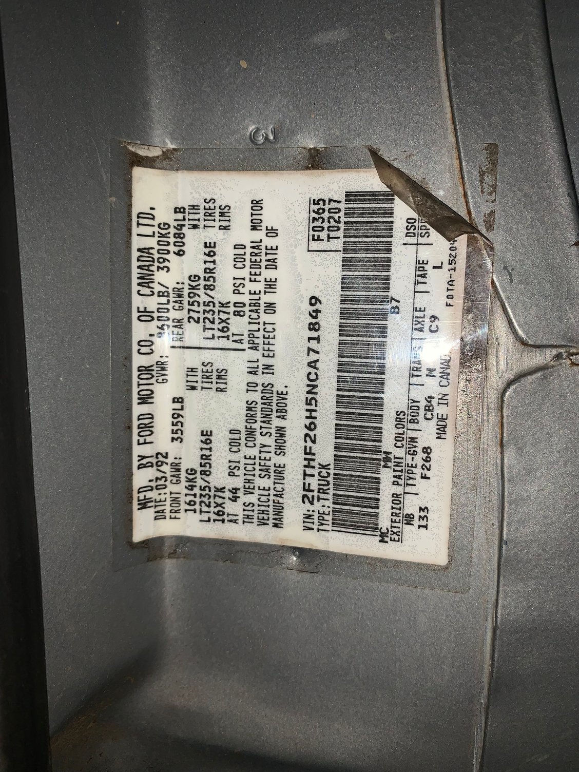

Can you provide the engine code on the door sticker ? Thanks.
Old Mar 6, 2025 | 02:05 PM
  #17
Kaden Tara's Avatar
Joined: Feb 2025
Posts: 39
From: BC

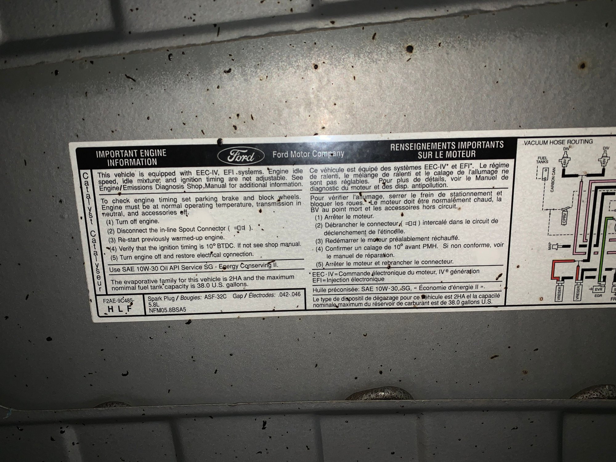

I found the vin number for the 351w and also vehicle vin number and sticker under the hood and on the upper intake manifold to start with .
Old Mar 7, 2025 | 05:08 AM
  #18
Posts: 16,587
Thank You for the info.
Specs vary according to engine size. Now we have some idea of what to check and what results we should expect.
Will get back to you.

Old Mar 7, 2025 | 10:11 AM
  #20
Posts: 16,587
I am going to ask you to try a few things. Since you already replaced the EGR valve, we won't need to clean that.
What I need you to try is; remove the vacuum hose from the EGR valve, plug it and see how the engine runs, OK ?
Please get back to us with your result, thanks. You may or may not get a check eng light, but that will go out when the vacuum hose gets reconnected.
What we are looking for is false vacuum keeping the valve open when not required which can cause poor idle or stalling.
You posted a partial pix of the vacuum hose diagram. Can you post a complete pix, thanks.
