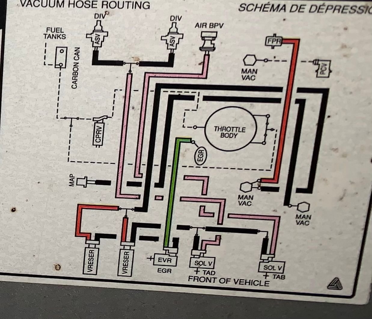

I have replaced vacuum solenoid for the egr valve when I done the egr valve and before I swapped the ecm from another truck I did check vacuum pressure with the gauge when the engine cold and so far leaks coming from egr solenoid and line
I got picture of vacuum line diagram

That EVE solenoid valve is supposed to be closed , preventing manifold vacuum from opening the EGR valve. That is why I suggested you remove the hose from the EGR valve and plug it. You can stick a screw or bolt in it. Drive the vehicle and see how it performs and if it still stalls, thanks.

I disconnected the vacuum line going to solenoid valve for egr I did test with a vacuum gauge I was getting 10 inches of vacuum and it sounded rough this time when I got it running but once I reconnected it I idle ok but when rev it let off the gas almost instantly dies but catches it is self

Please, just remove that hose from the EGR valve, plug it and drive your vehicle. That is a better test. Thanks..

Well new update I disconected egr vaccum line and drove it same surging and stalling happing even when the engine is not warmed up so next move I did check to see if Any lines were so far no vacuum leaks . I did some vacuum lines going to the vacuum tank and Vapor canister line going to throttle body and tried the rebuild ECM still stalls after reving up the engine so I put The ECM from the 302 back in for now and that one works good does not stall the engine out
I have done fuel filter change on it like 3 months ago
I have done idle air control valve last year
I am just wondering now if it’s wiring harness problem in my truck and what else is making the engine stall out after reving it up when it’s operating on 5.8 351W ECM
I assume it most likey electrical isuse becuase my truck has never done this before since I owned as of 2023 . I am wondering anyone`s got any ideas or thoughts on what else could be going with my truck because I have never encounter this kind of problem with the orignal 5.8 l pcm before
