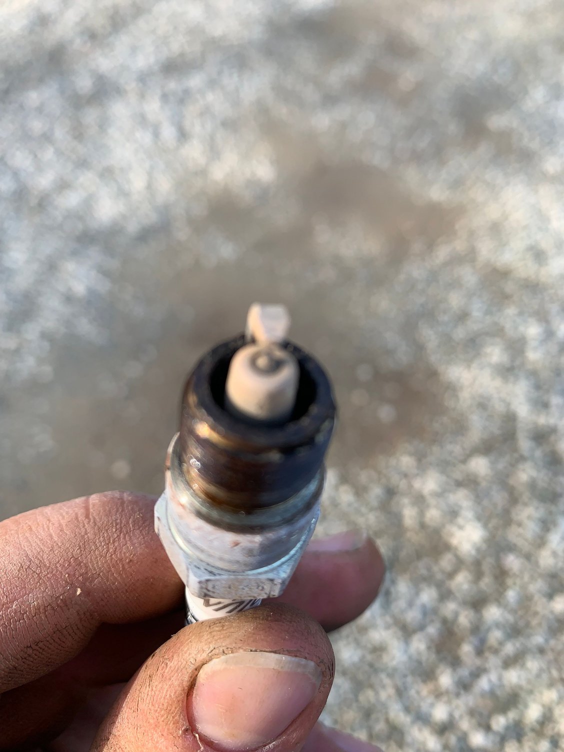

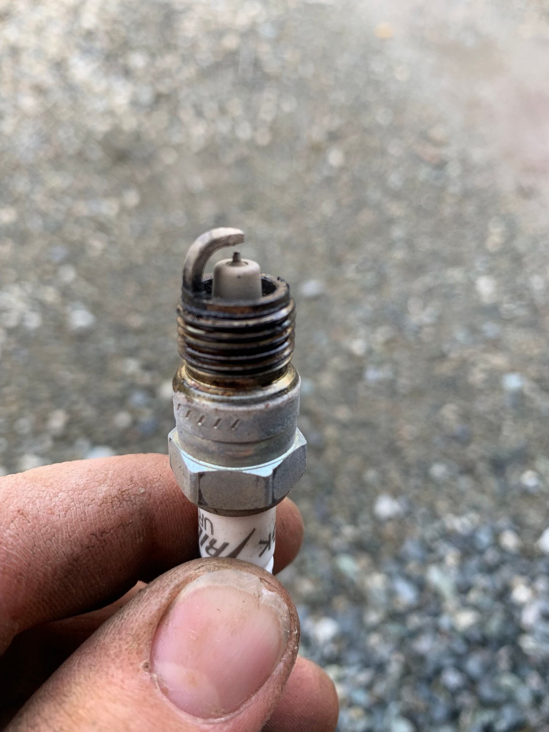

I got 2 plugs pulled out this what they look like now
Old Mar 30, 2025 | 08:36 PM
  #36
Posts: 16,589
From your pictures, the plugs appear dry.
So now we know fuel is not getting to the cyls..
