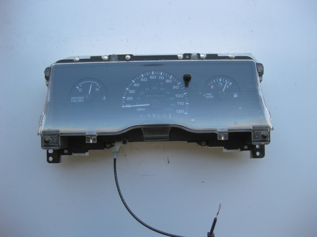

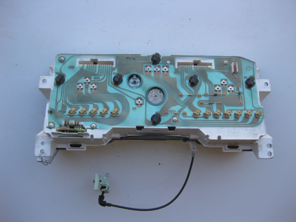

backside of a cluster:Name:  IC507b.jpg
Size:  144.2 KBFront of the cluster:Name:  IC595.jpg
Look for loose connections, loose ground connections, broken solder joints.
The speedometer uses stepper motors and sometimes the needle hangs at a speed and jumps up or down.
