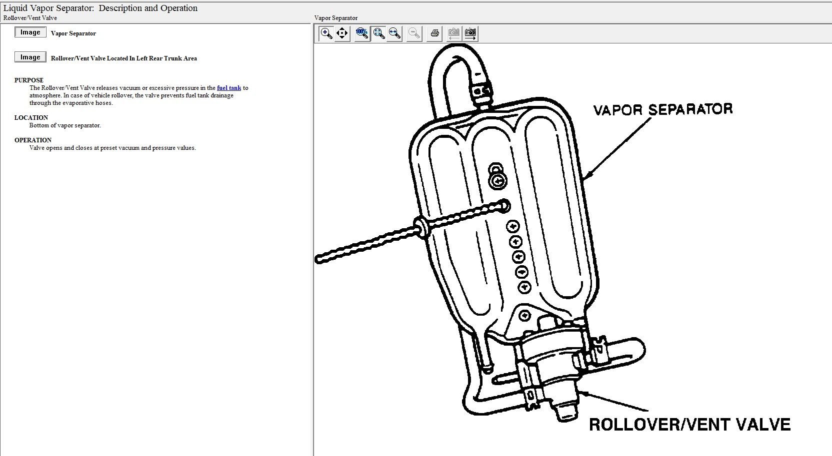

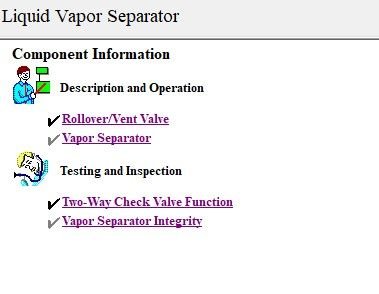

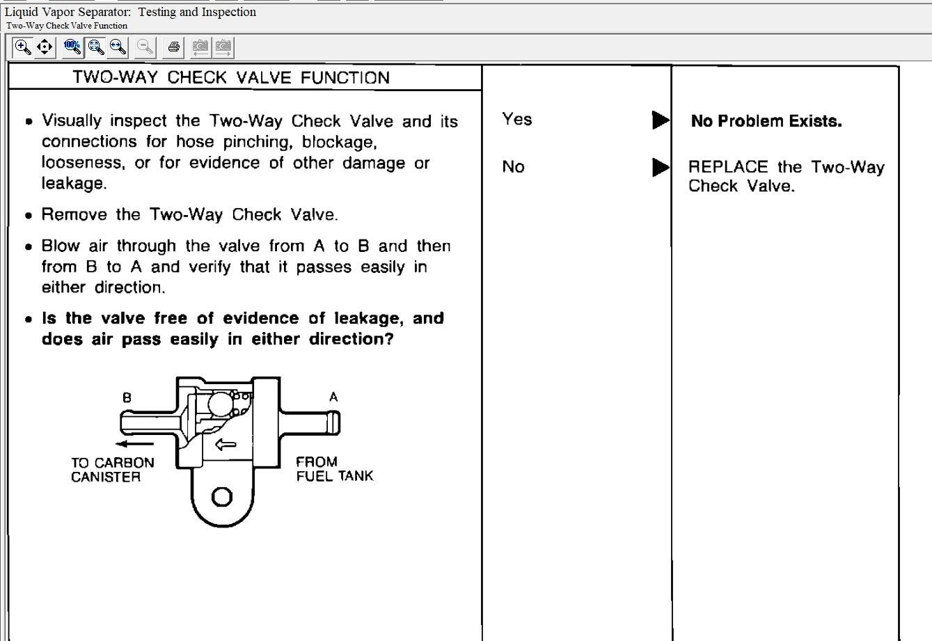

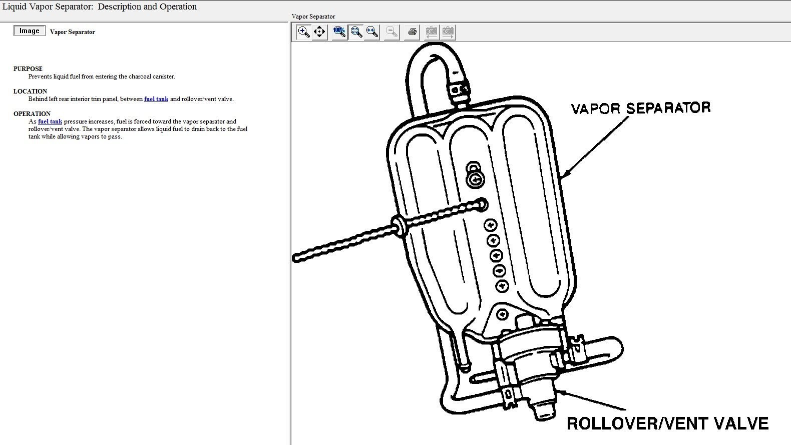

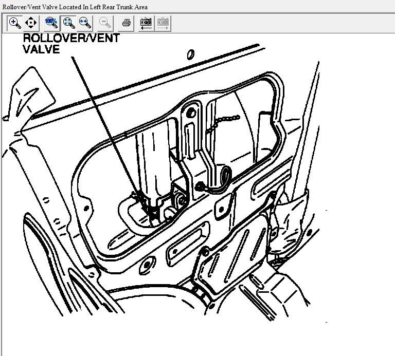

Based on your symptoms you might have vapor lock issue so check the separator first.
Aftermarket approach check: https://www.ebay.com/itm/295727528562
