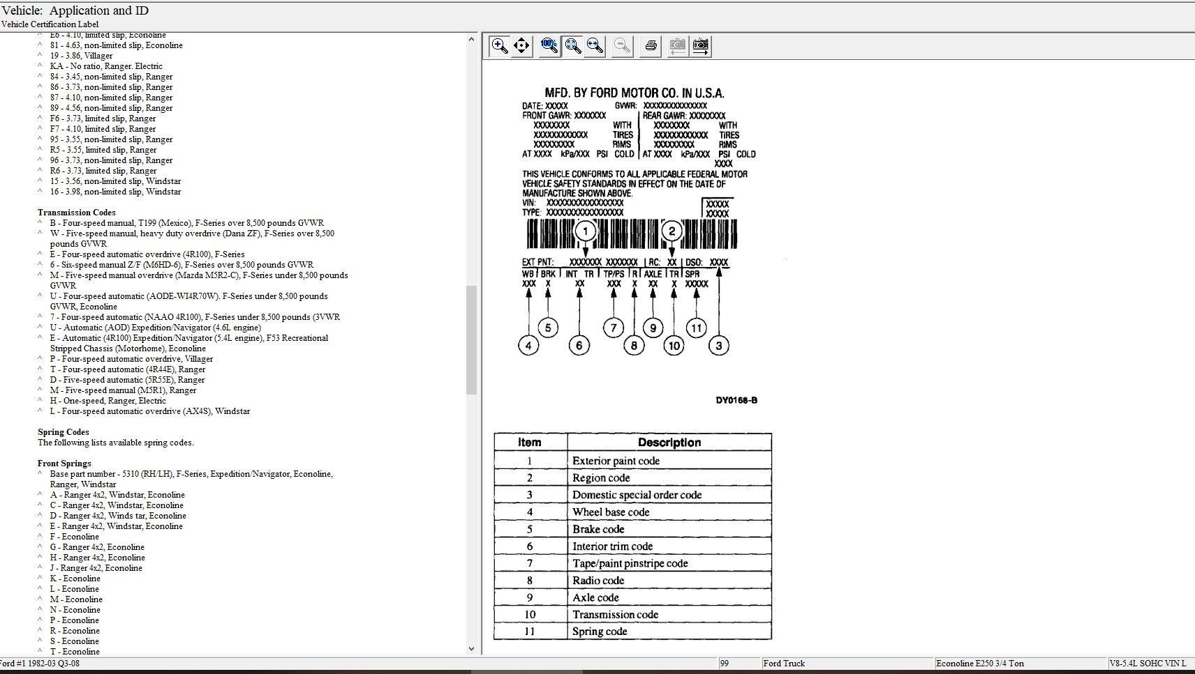

Check #10 and see, if you have a "7" then 4R100, a "U" then 4R70W, assuming you are the sole owner or the previous owner never swapped the tranny.
