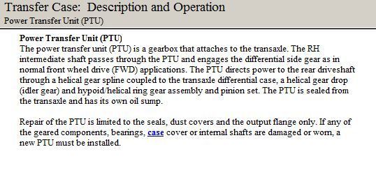

My concern is that it may be the transmission. The passengers front and both rear wheels attach directly to the ptu and the drivers front attach directly to the transmission.
It seems as though the drivers front is the only wheel affected but all research points to the ptu, specifically the propane smell and the fact that it’s never been replaced or fluids changed(sealed unit).
