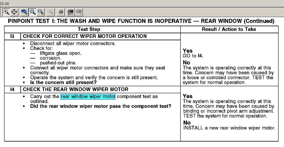

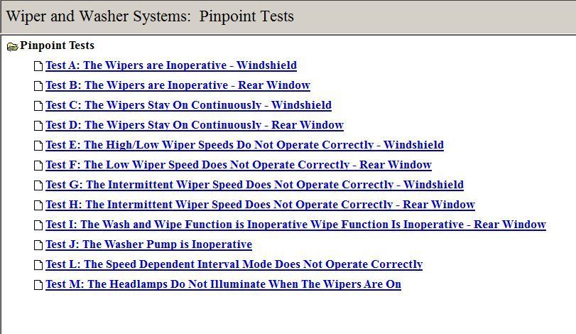

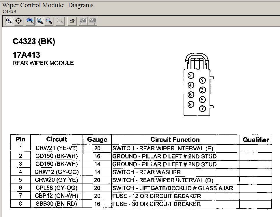

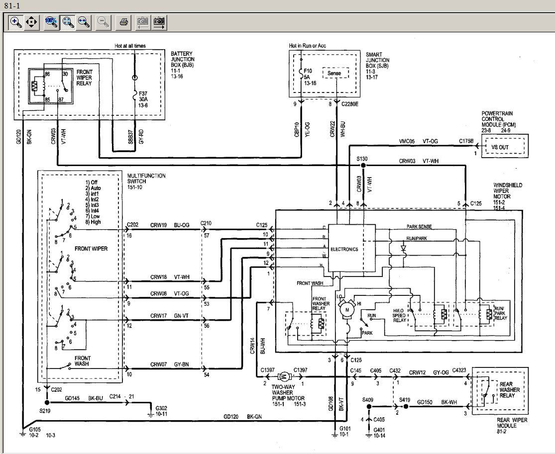

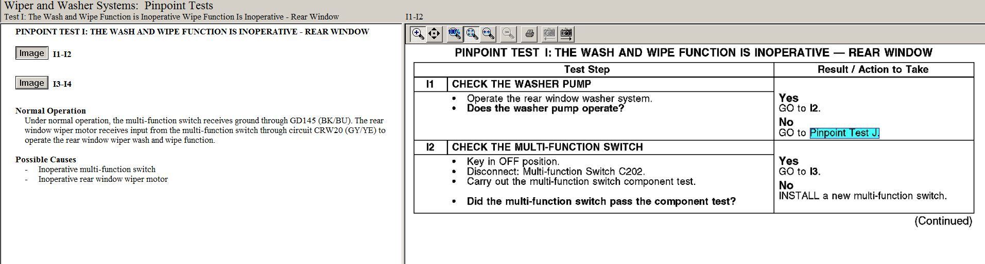

I picked out pinpoint D (above) and i (below), best possible match as shown above, even though no exact pinpoint test shown.

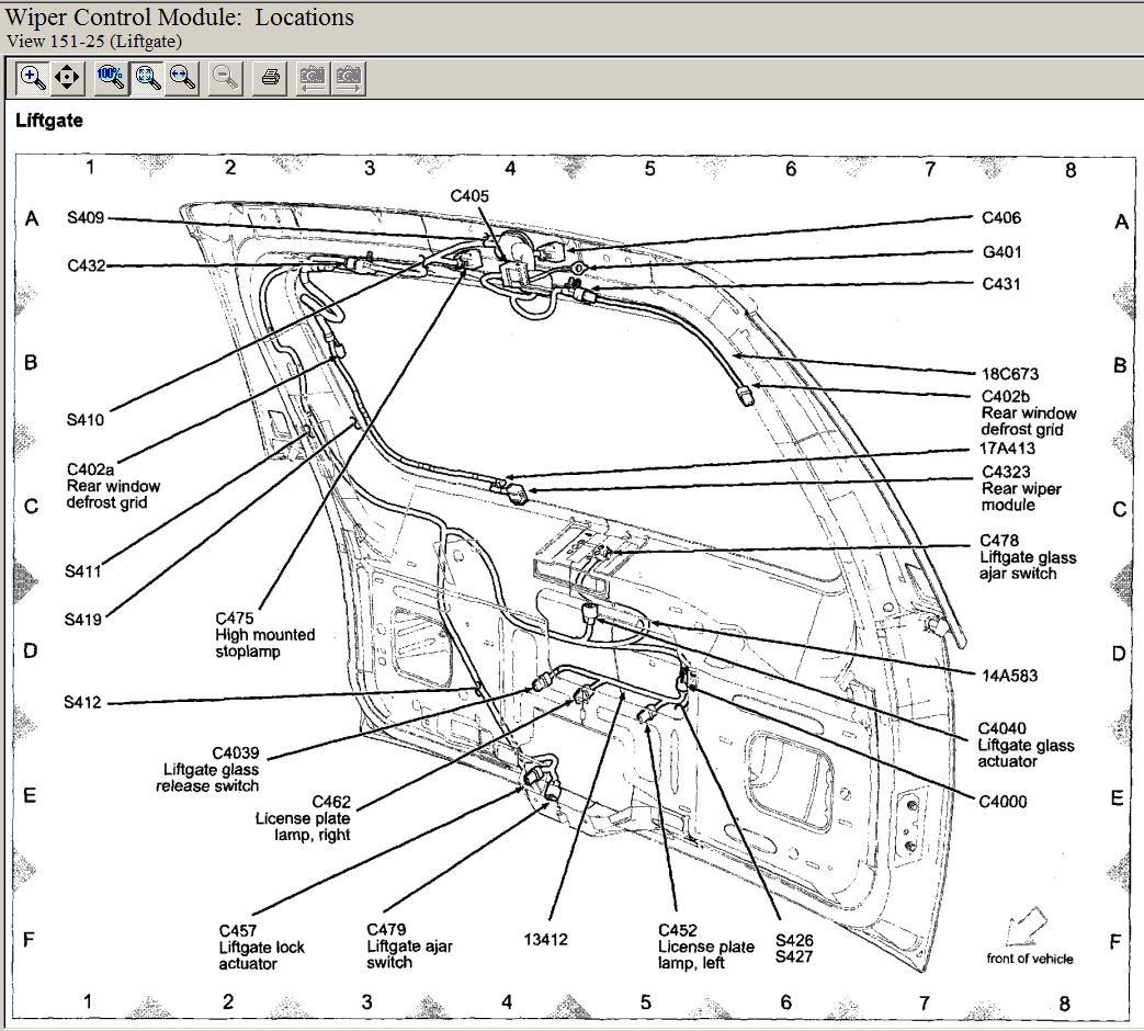

Check Rear Wiper Module 151-25 above and below, C4323 below.
If you look at the 81-2 electrical diagram above you can see 2 relays integrated into your rear wiper module, one is for washer the other that says "up" that is for wiper. If you have sticky relay then self activation is possible. So if at all possible, remove this module and disassemble it and spray electrical contact cleaner or 91% isopropyl alcohol spray type (Equate brand from walmart/cvs). You can't lubricate the sealed relays and they are probably soldered onto the circuit board anyway.
Don't forget to download 2 PDFs attached below.

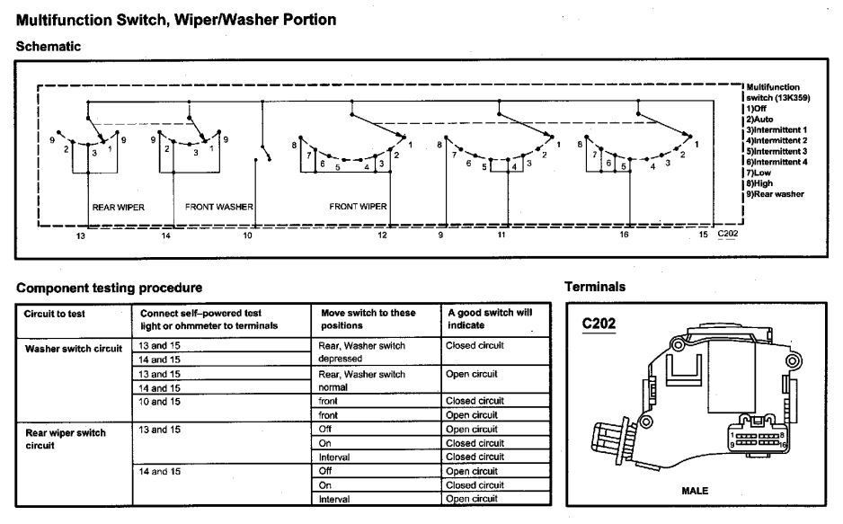

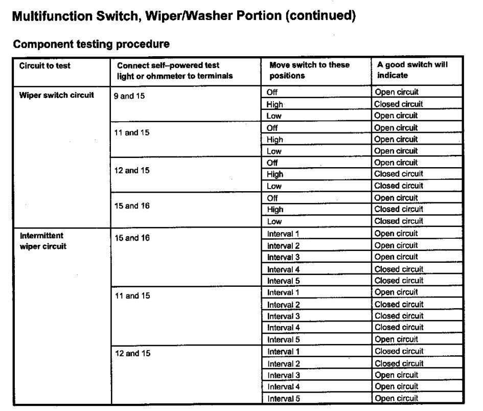

Since you have multifunction switch removal under your belt so you might want to check the component procedures shown above.
