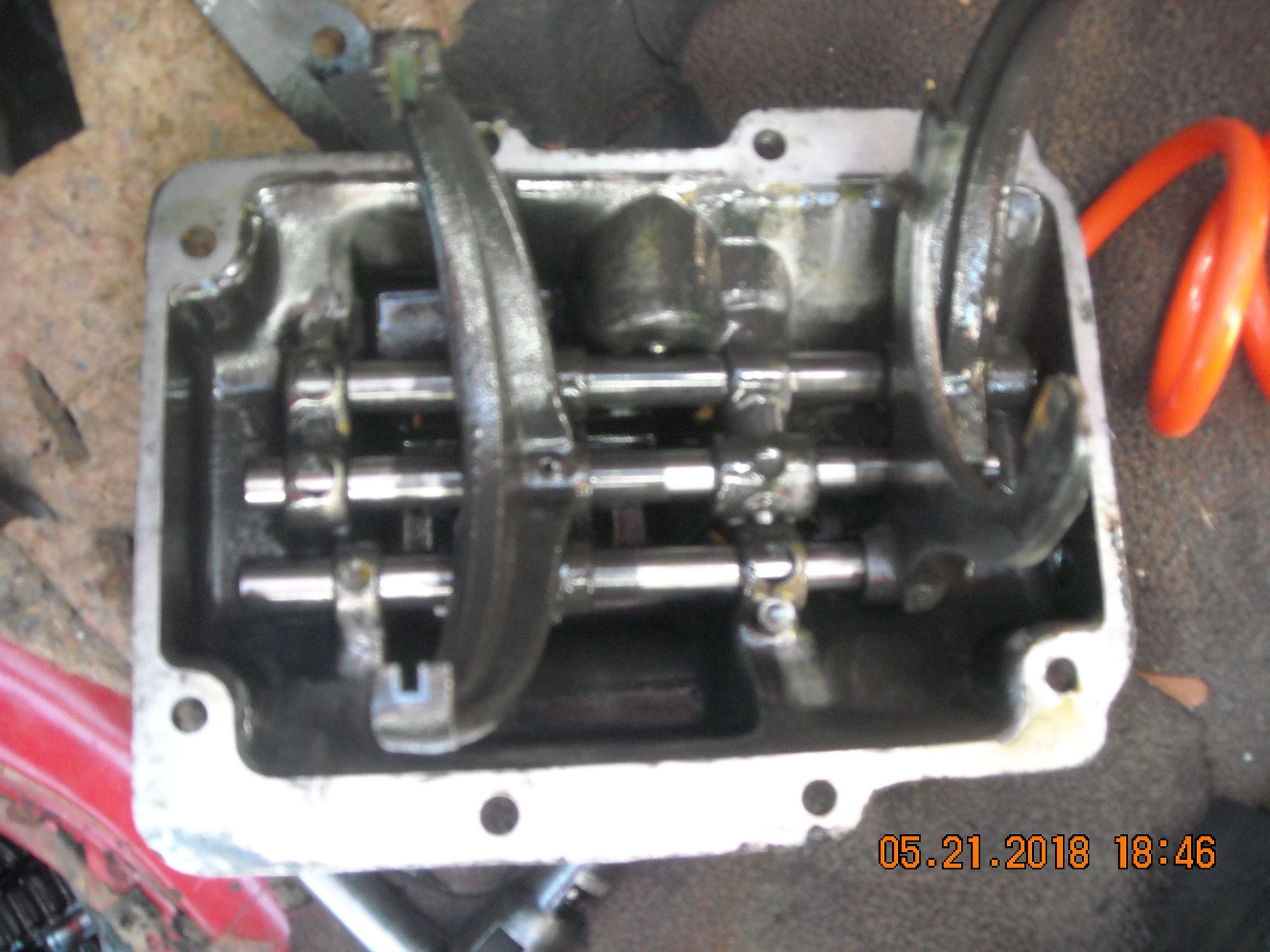

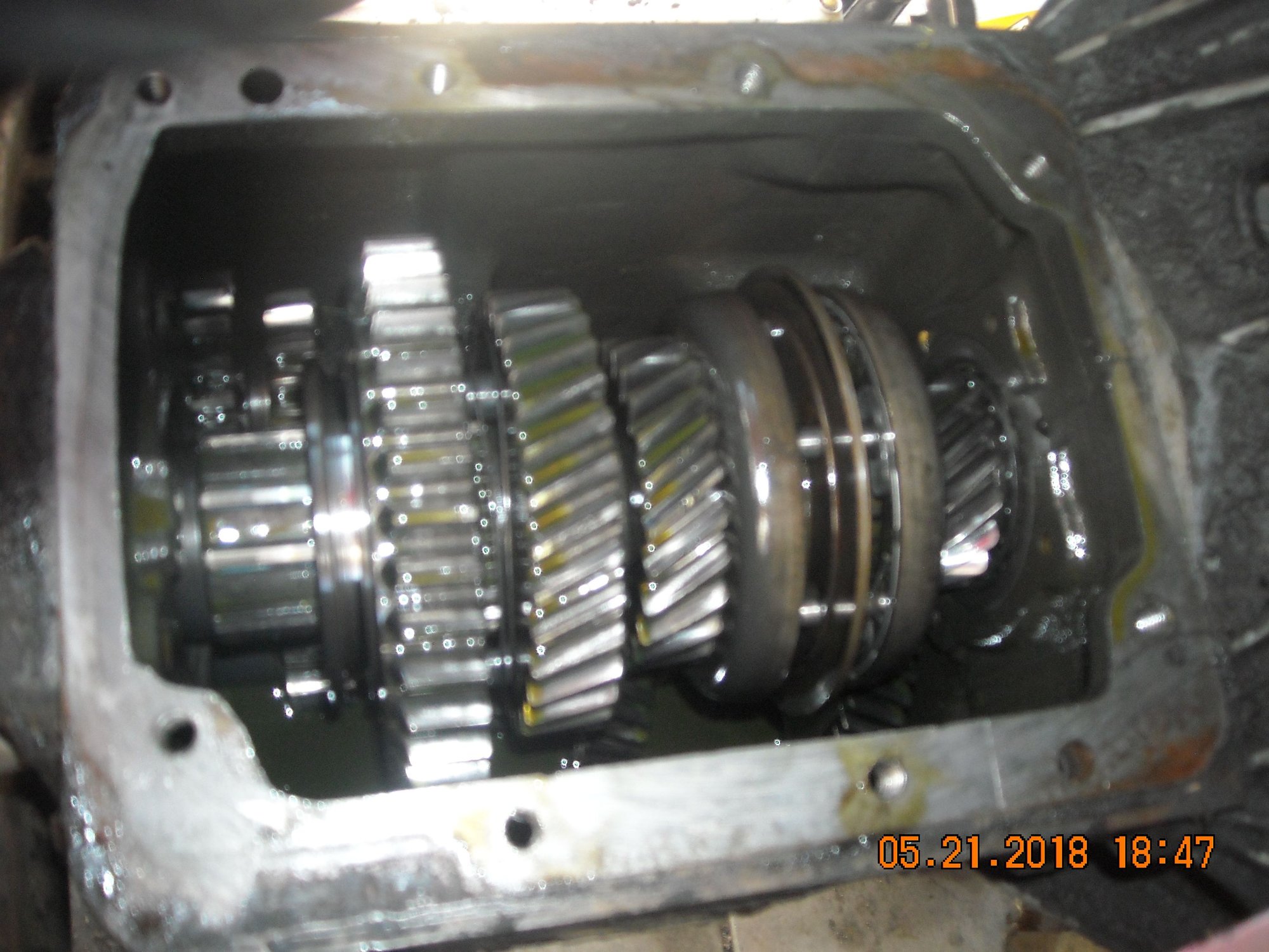

What do I look for?

First, You should now be able to move the shift lever and move any one of the 3 shift rails depending on where you position the shift lever. You should be able to move all 3 rails , but only one at a time. Can you do this?
In looking at the upper pix , it appears the shift fork is upside down. The slots in that larger shift fork are supposed to drop onto the center of the forward synchronizer assy. which provides the last 2 higher gears. That is how I see the pix . Has anyone been in that shift housing and changed anything?

Unless the last guy who did the clutch messed with it I do not know of anything changed. It shifted ok before I started on this. Clamped down on a bench I can get the shift stick into. I think, all 4 gears. Remember a novice so I do not know what or where the "forward synchronizer assy" is or what it looks like.

It's like an optical illusion, but the shift forks are OK.
The R/S of pix 1 with the shift rails goes over the rear of the trans.The fork goes into the slot just behind the largest gear.
The other larger fork has a slot in each end and that slot goes over the center ring of the assembly just adjacent to the smallest gear (input gear). The assembly is called a synchronizer. That allows you to shift into the highest and next highest gear with out gear clash.
Since you can now shift the lever to just about any gear , it confirms the shift tower is OK. Carefully insert the forks , one over the center of the synchronizer and the other fork in the slot near the rear and the top of the tower should drop right into place as long as the slots and forks are lined up.. Then install at least 2 bolts to hold the tower down and try shifting the lever now. You should be able to get it to go into at least one or two gear positions. Be careful not to damage the gasket between the trans and the tower assy. Let us know if you are successful up to this point.
