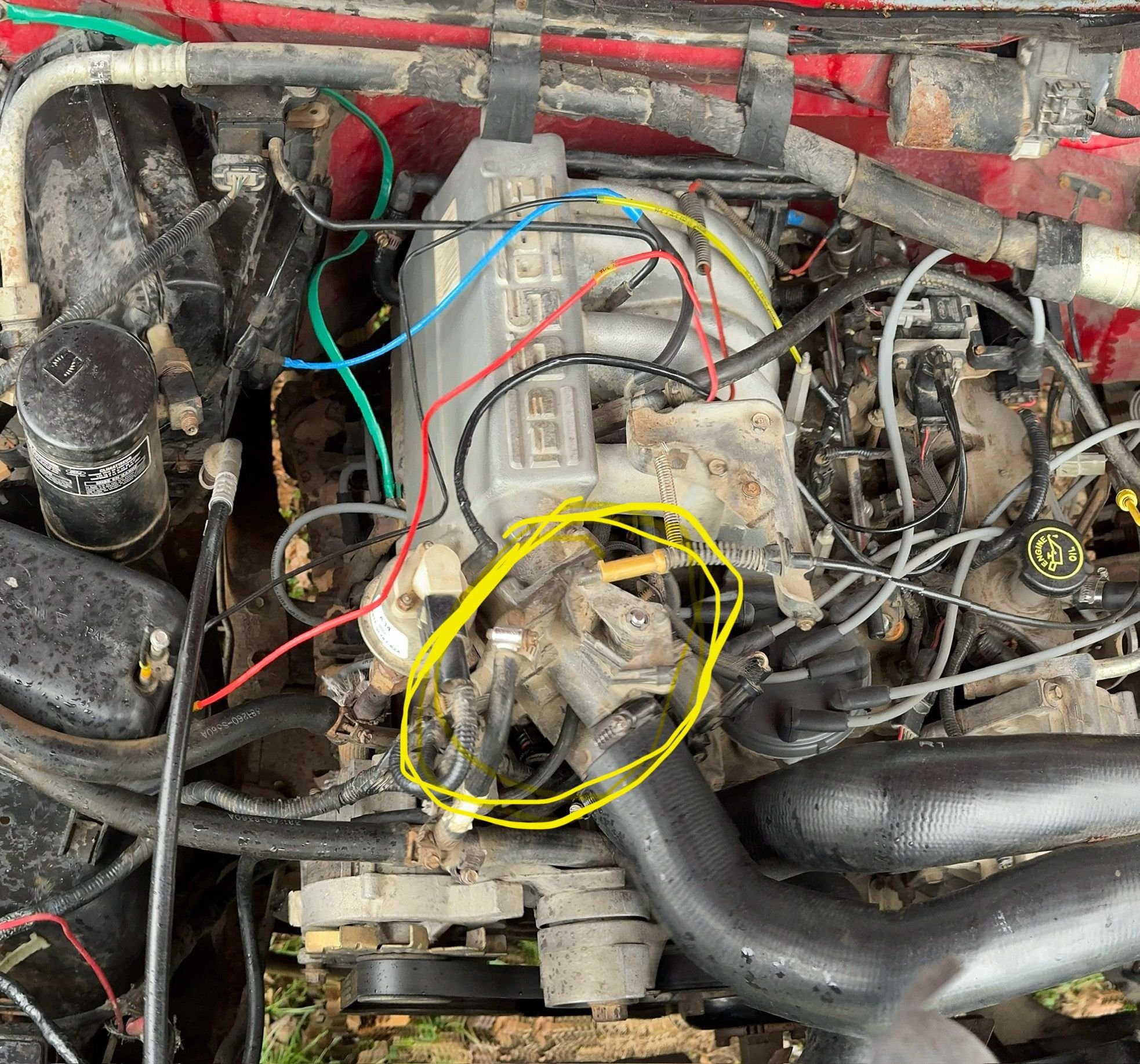

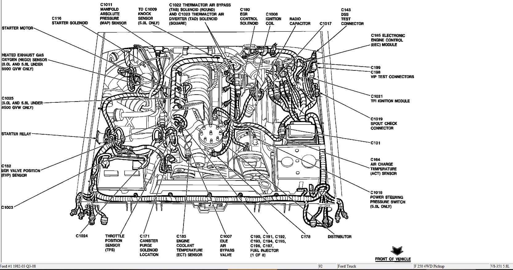

So I’m gonna put a picture on here of what my engines looking like of what I’ve got going on I’ve been messing with with the vacuum lines and what not
Just cranked it over They got out to look under the hood, smelled gas and leaking under there off some not sure what it is

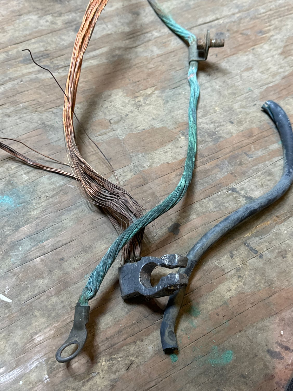

Default I think I know why my f250 won’t start.
Just sniffed this out today.
Ground wire off battery
