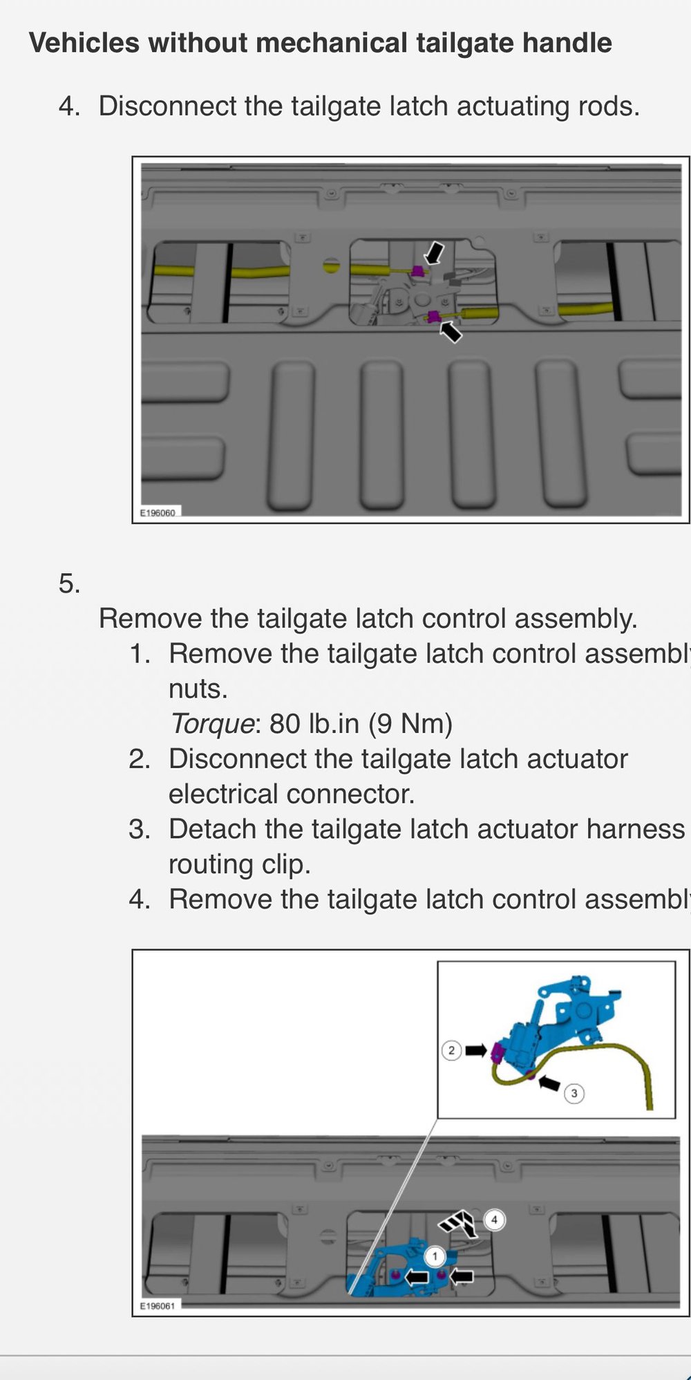

Hayapower, where can i find the solenoid?
Old Nov 12, 2023 | 09:31 AM
Its behind the inner tailgate access panel attached with 8' screws.
Make sure to check the connector for switched/power distribution before condemning the old actuator solenoid.
