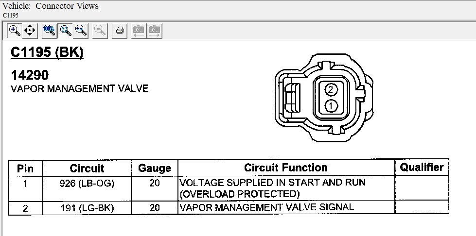

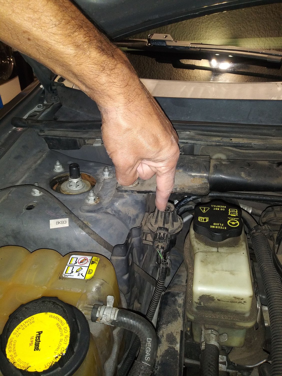

Greetings, hope this thread finds everyone well. Would someone be able to help me out with my car? I went to start the car and it didn't do anything. There was a vibrating sound coming from a component in between the antifreeze reservoir and power steering reservoir. It looks like a small canister with an electrical plug that goes into the front. When I unplug it the noise stops but the car still doesn't start. Seems like this component is what causing the car not to start. I've attached a picture of the engine compartment. Please let me know if the picture clear enough. The car ran perfectly earlier in the day. I did have the key in the on position with the with the car off earlier while I was trying to check the windshield washer pump.

Thank you for the reply! The battery is only 2 months old. We purchased it brand new. When I turn the key that particular component can use to make a rumbling sound. Do you know what that component is called that is in between the antifreeze reservoir and Powers steering reservoir? It has a plug in the front of it and when I unplug it the rumbling stops. Dear is plenty of power coming from the battery. Thanks again!

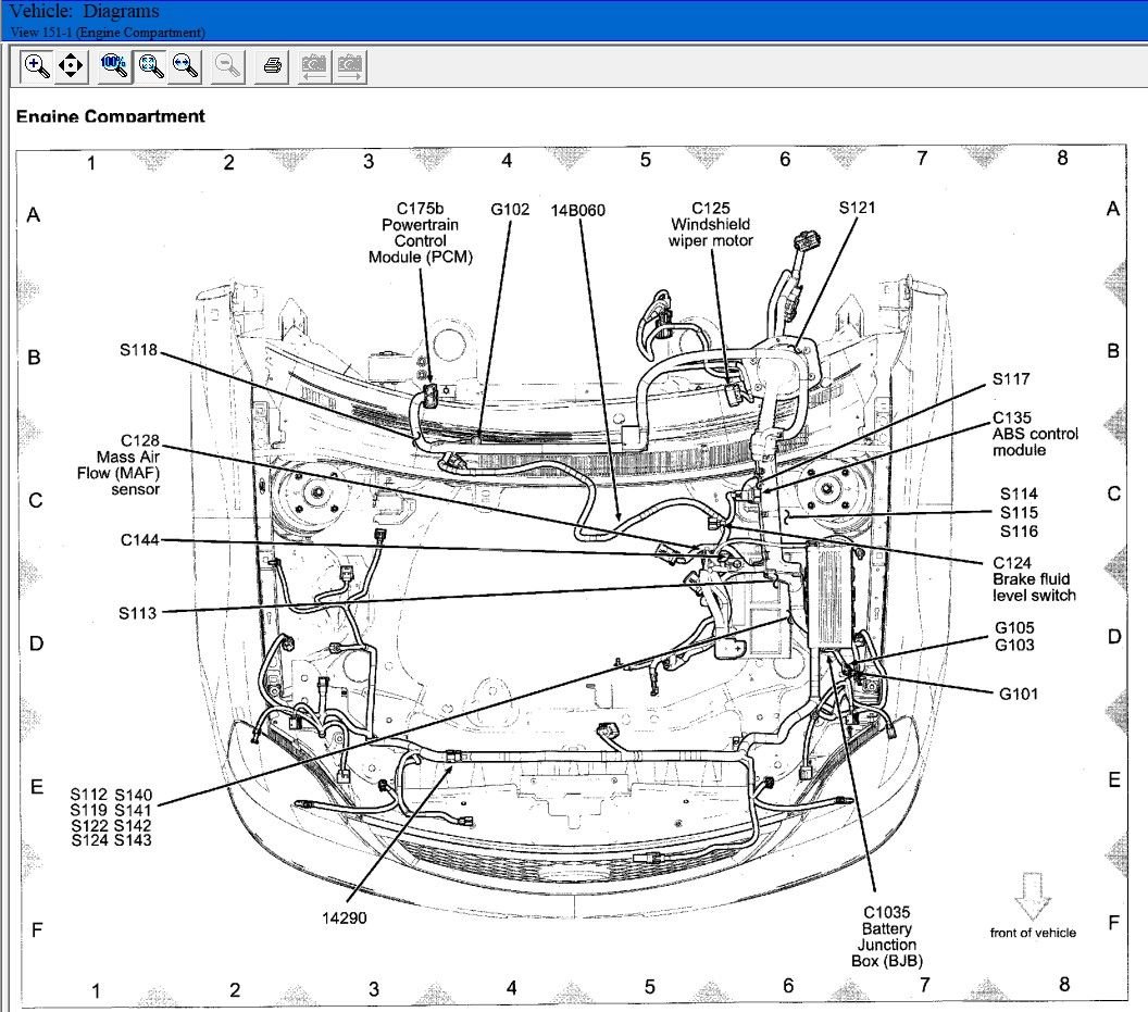

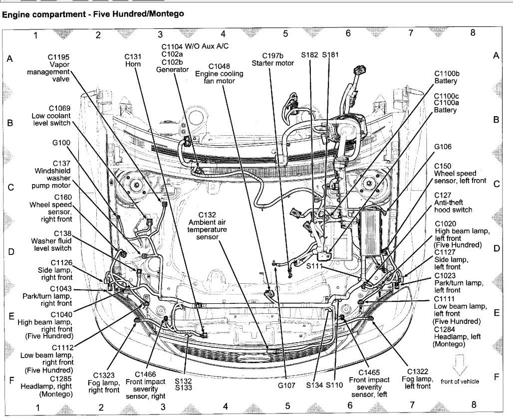

Posts: 1,221
No crank no start check Pinpoint-A.pdf below.
I noticed your ground strap maybe, and it's in wrong position perhaps. If and only if G100 (locate from diagram above) has no ground wire at it, then below diagram locate red arrow and move it to blue arrow (underneath) or where G102 at the very last diagram below. Make sure you wire brush and clean the connector as well as G102 very well before moving.
