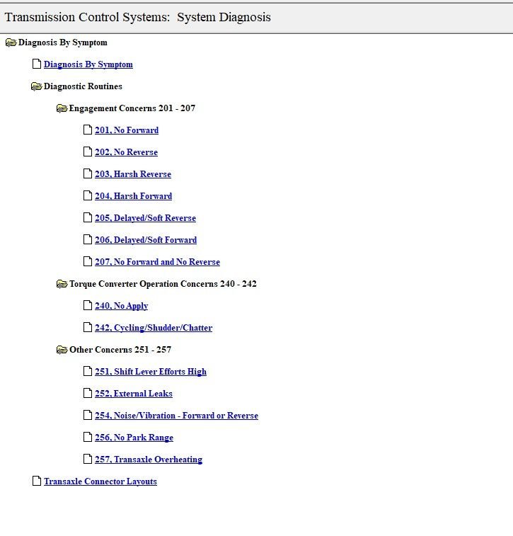

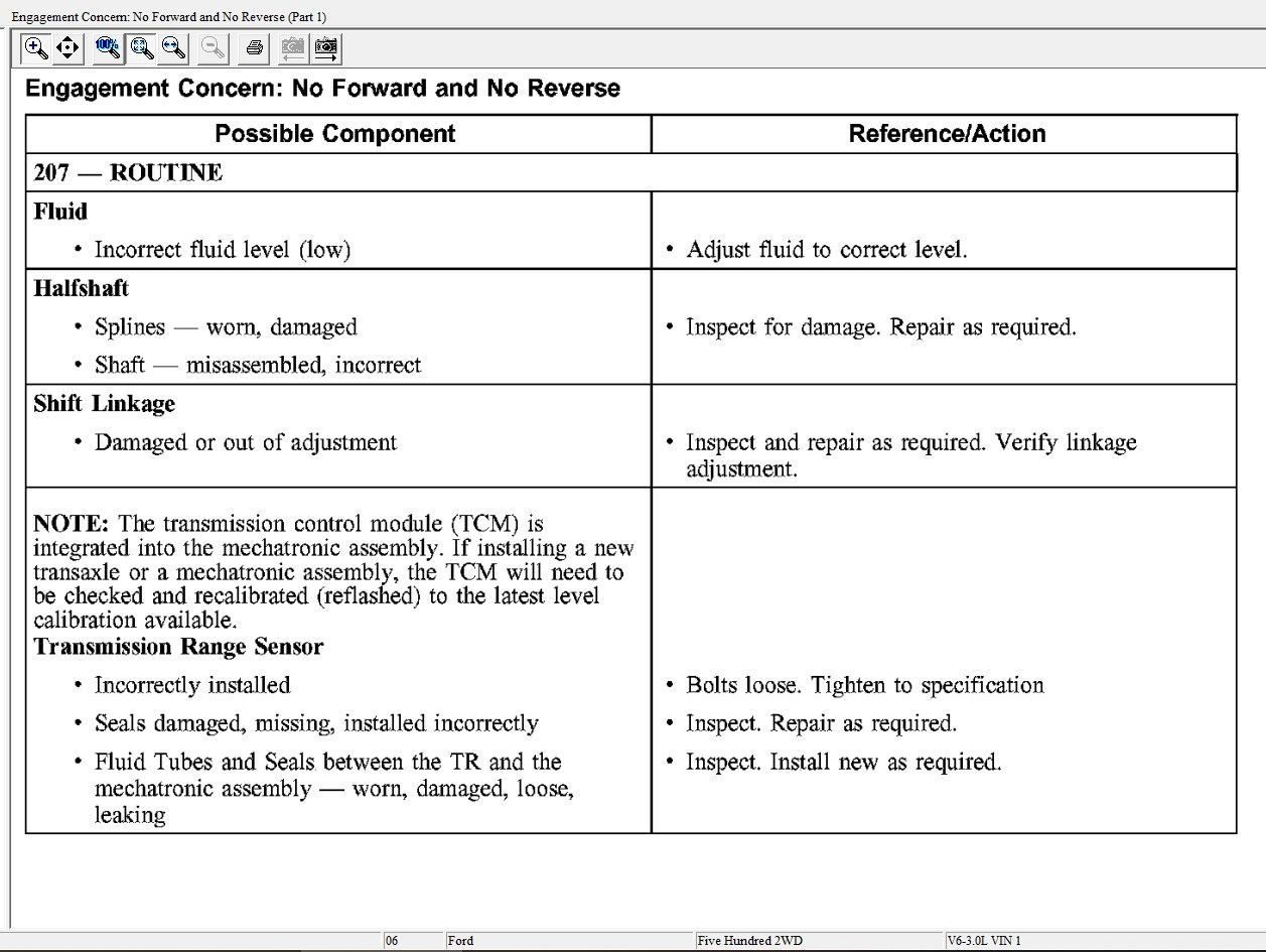

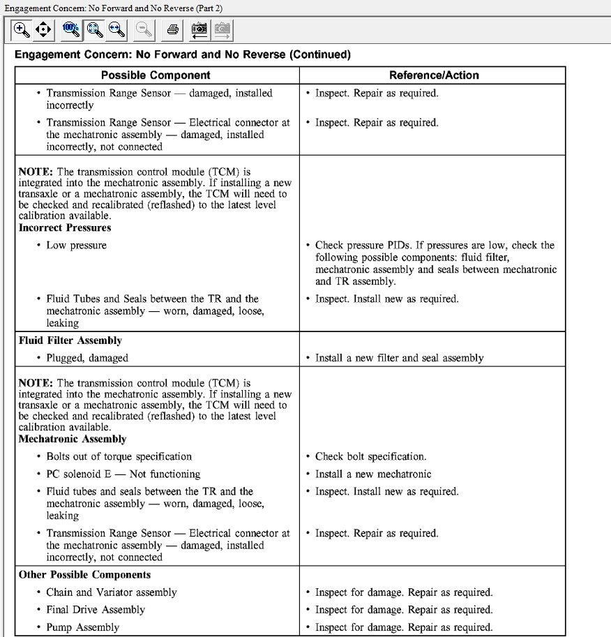

No forward and no reverse shown below. If you need the others check pdf attached below.
