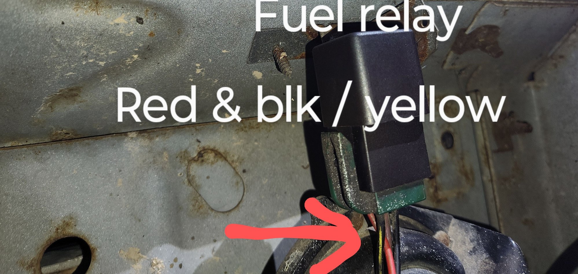

My question is that there are two sets of wires coming into the engine bay that run the fuel pump.
A blue and a black wire come together and when I turn the key, they power up the fuel pump. I connected those to the starter relay battery side.. ok.. but
There are another set of wires, a red wire with a yellow stripe connected to a black wire with a yellow stripe on a fusible link.
If I connect those to power, the fuel pump will run continuously.
I do not know therefore, where to connect these two wires.
I cannot get the key to crank and crank continuously other times..
It just stops with a loud clank in the new starter relay.
I am afraid that I have some wiring issue and I'm wondering if it could be with these two stranded wires.

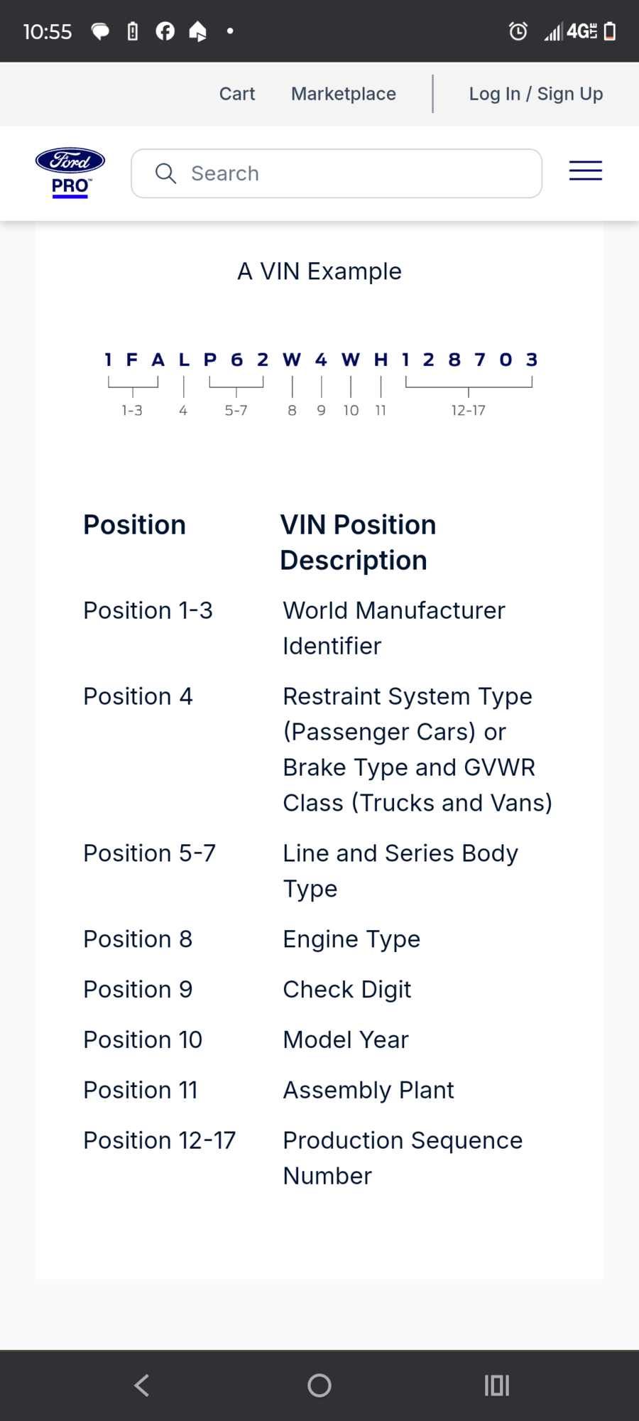

I looked at my VIN code and the 8th letter is L which indicates a 460 see the pictures below.

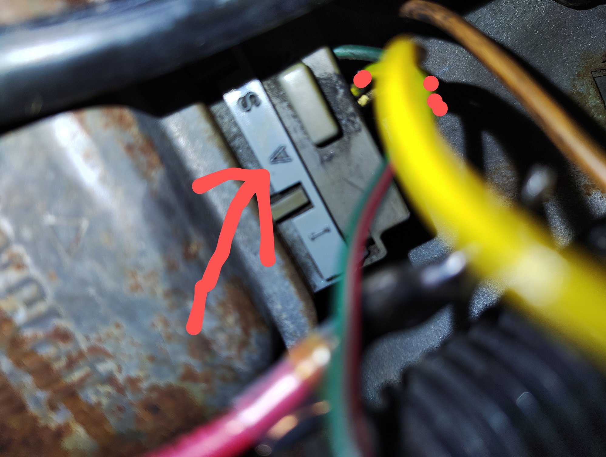

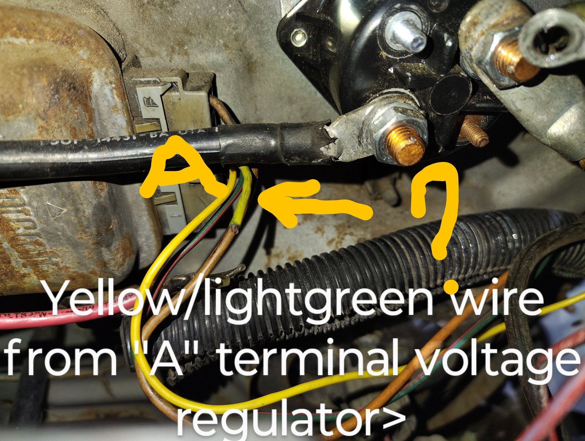

I will send detailed pictures this time to make it easier to understand.
But there are two wires coming from the fuel pump relay and I don't know where to hook them up.
If I connect them to power, the fuel pump just stays on.
I cannot find diagrams that match my wiring because I'm not seeing inertia switches or neutral safety switch type stuff.
I will send pictures and see if anything jumps out at you.
