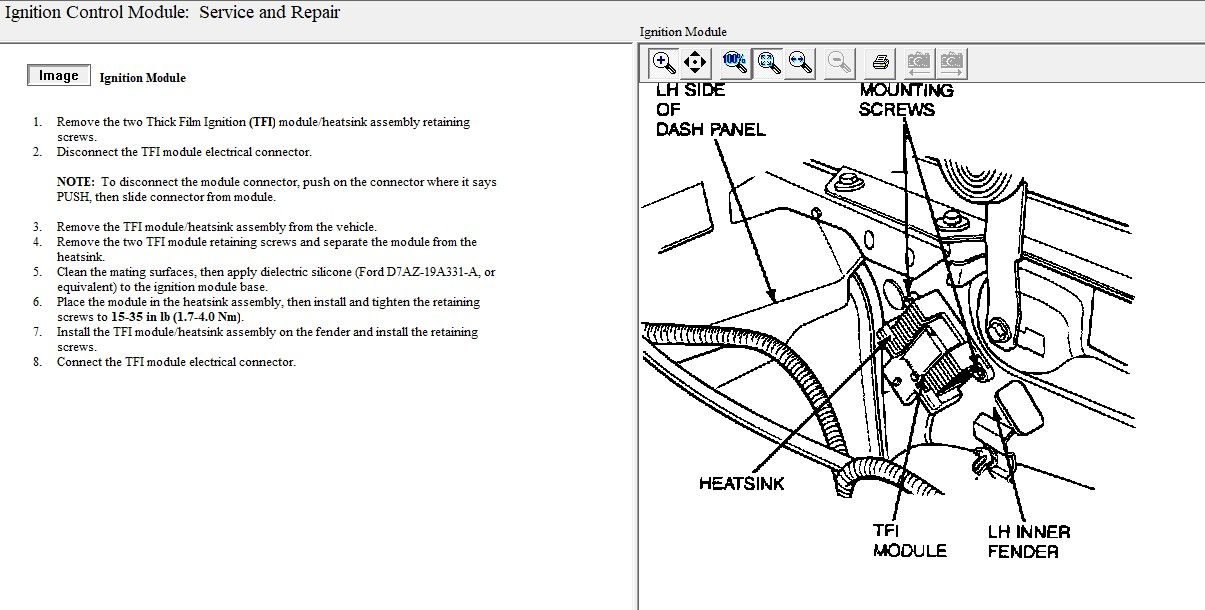

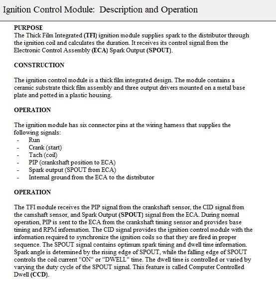

Check your ICM (Ignition Control Module), is it mounted on your distributor or elsewhere like driver side fender?
Next time you wait for the cool down before a restart, you can try to cool down just the ICM and see if it helps any. Like using a fan with a funnel or a tube or air compressor and blow just the ICM.

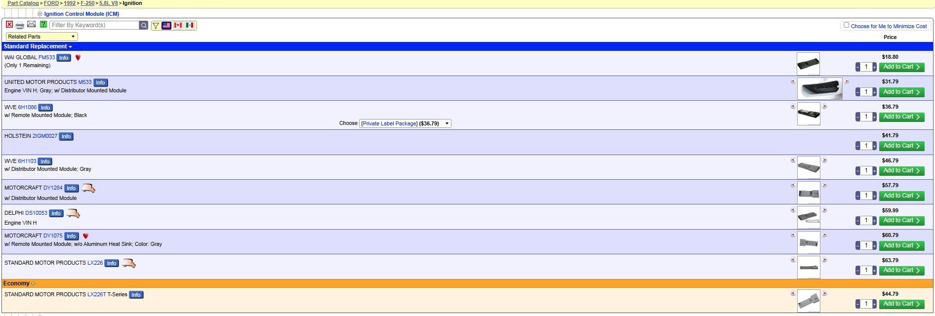

Get either Motorcraft DY1075 or DY1284. The distributor mounted one requires special tool to remove. Check on Amazon first, free return if it's not the issue. Buy at rockauto use 296207085264063635 (expires 4/18/25), not free return but if you buy return label from them it's very reasonable.

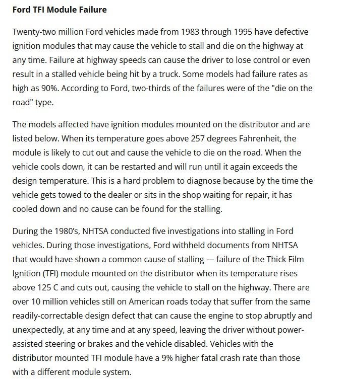

Check out the Ford TFI module lawsuit settlement here. A snapshot shown below.
There should be a relocation kit or you can DIY and relocate it to elsewhere. Relocation detail check here.
If yours is distributor mounted you might want to take the relocation approach instead of buying a new module.

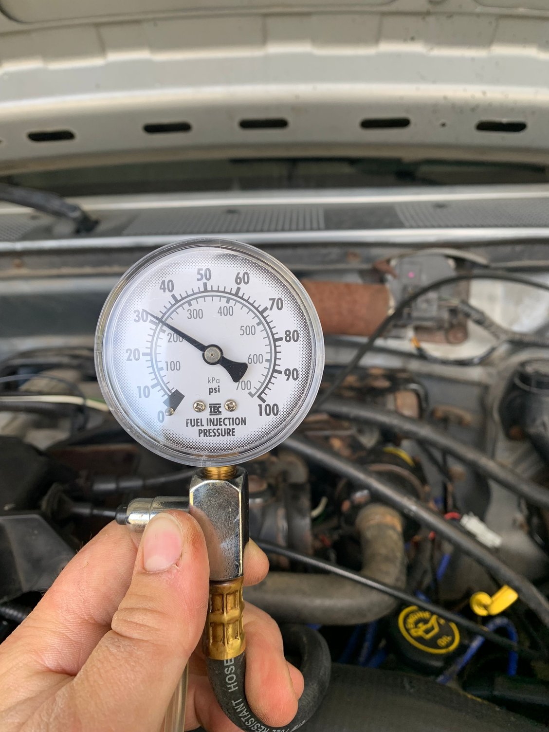

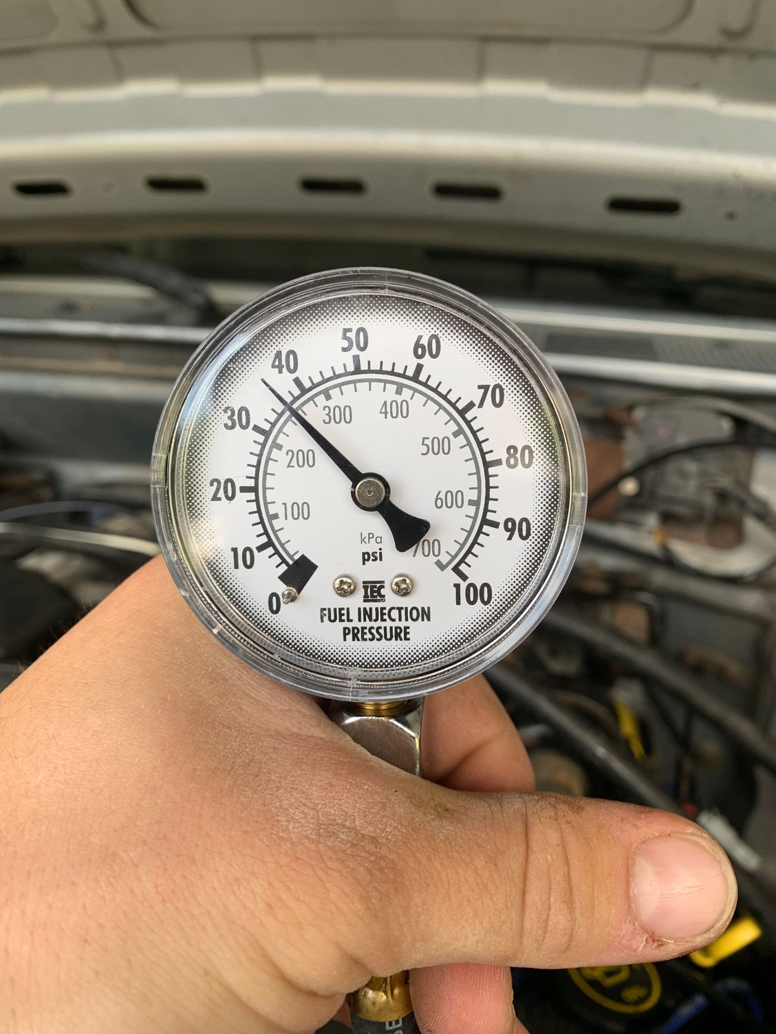

I’ve checked fuel pressure today and sitting out 31 psi while the engine is idling and 37 psi ignition on with the engine off on both fuel tanks my ignition module on the driver side fender I have replaced that before

Can you take your vehicle for a drive and have that fuel pressure gauge where you can see it ?
If so, when your vehicle decides to stall, see what the gauge reading is at the time of the stall. If at normal pressure, no need to waste anymore time and effort chasing a fuel supply problem.
Time then to concentrate on ign system. Please let us know , OK ? Thanks.

If it was a wrong timing like too retarded you can feel the lack of power without a 30 minutes drive.
Your fuel pressure after a 30 minutes driving or you think the engine is about to stall, if it's 28 psi or lower while engine is running, then you can have fuel problem.
